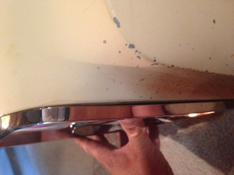

I have tried everything to make them fit. I did not want to change anything on the el Camino, so I have been experimenting on the extra Malibu header. I removed the nylon nuts that push into the headlight bucket and replaced them with much smaller ones I found at O'Reilly's. This allowed the bezel to fit better, but still does not fit flush on the sides. The Parts Place has not contacted me since I sent them pictures, over a week ago.  I emailed them tonight and told them I want a different set or refund. We will see how this goes. Might be the first and LAST thing I ever order from them.New headlight bezels for 76/77 - Page 2 Image23

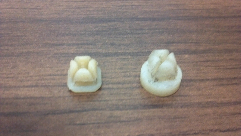

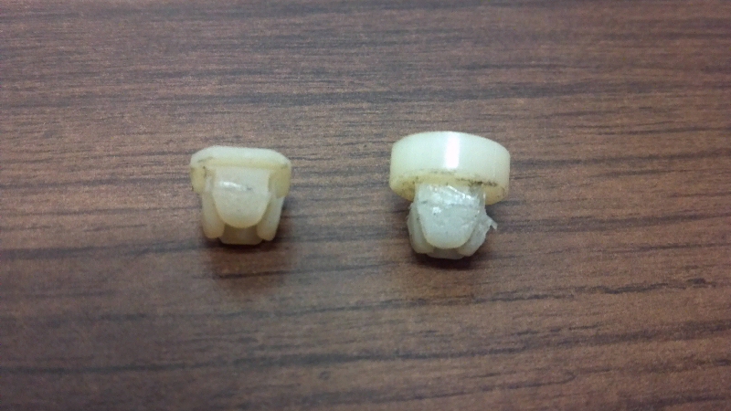

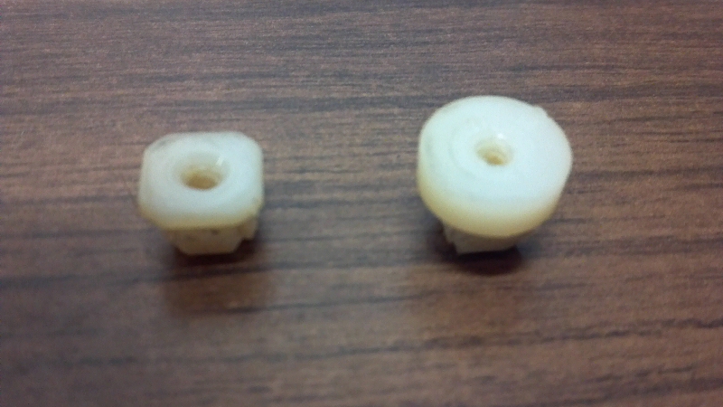

There are two different nut inserts used to hold the headlight bezels to the headlight housing.
See pictures below.
There is a thin one and a thick one.
Using the think one when you need the thin one would probably give you a gap?
New headlight bezels for 76/77 - Page 2 Bezel_inser_01
New headlight bezels for 76/77 - Page 2 Bezel_inser_02
New headlight bezels for 76/77 - Page 2 Bezel_inser_03

Yes, I'm aware of the different inserts. I did try and use the smaller inserts. The picture of the tan header is using the smaller inserts. I original posted that the bezels were deeper than the originals but later came to the conclusion that they apeared to be warped in the middle, which made them seem deeper. I did explain this to The Parts Place but they must not have agreed with me.
