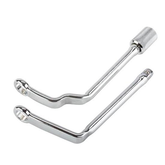

If I am thinking about the same bolt you are talking about (it has been quite a while since I did the shocks on my car), I was told by an old mechanic the trick was to use a distributor wrench http://www.speedwaymotors.com/Performance-Tool-W1189C-Distributor-Hold-Down-Wrench,8639.html    It worked quite well.
Rob

I never finished the conversation here. A different day and the job seemed much easier. I put a vice grips on the first nut I rounded off and an offset box end on the other three. Piece of cake. I'm slowly realizing that stepping away for a little while is often the best solution. Thanks.
