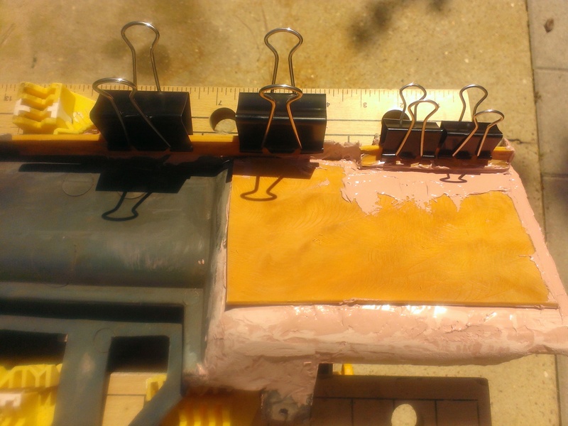

Post by g3chevy on Sun Aug 14, 2016 7:27 pm
I restored my 75 Laguna bumper fillers with 3M Flexible Parts Repair filler. Just make sure that you scrape off any urethane that is sticky and white from the bumper filler before you apply any repair compound. This white sticky layer is degraded urethane that will eventually come off. This will make any repair short lived. I used a dull razor to scrape it off my bumper fillers as sandpaper clogs immediately. I also reinforced the flat part under the license plate with a piece of urethane cut out of a 79 Trans Am nose. This made the part much more rigid and less likely to sag over time. Here are a few pics.

Post by crice63 on Mon Aug 15, 2016 1:45 pm
Nice work.
