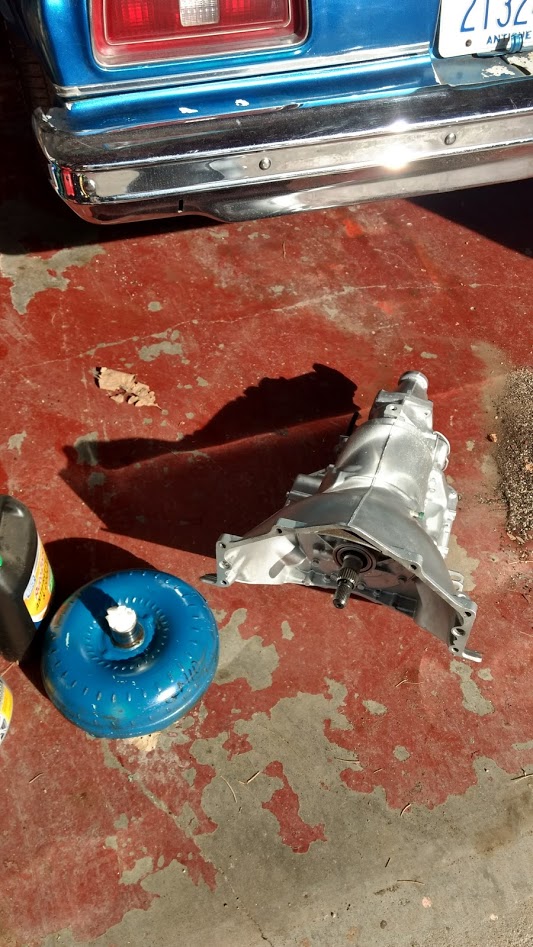

I am working on getting the transmission swapped out. I do have a friend that rebuilds transmissions, and he had a unit ready to be built, so I swapped him one that was under my bench. Got the correct gears for the speedo also.

Did a quick teardown of the old transmission. The snap ring on the shaft that holds the center support together came off or was broken. My builder said that happens from too much end play. That ring must be the metal flake I saw in the oil because it was completely missing.

Is the converter stock as well? A little extra stall in the converter will help it accelerate as well. I would look for about 2200 stall to not affect highway cruising.
Fresh 350 in a 74 Chevelle - Page 2 Empty Re: Fresh 350 in a 74 Chevelle
Post by fasrnur on Mon Mar 20, 2017 8:32 pm
I used a converter out of Super Turbine 300 for many years behind my mild 350 with great success. It stalled right around 1900-2100.
Post by bigredlaguna on Mon Mar 20, 2017 8:48 pm
I would say that the convertor is a stock or near stock stall. The transmission it came out of was in another car of mine that had a 383 w/280 magnum cam. I remember it not taching up like the engine needed so it was a bit lazy from a stop. I'm not really concerned with having a higher stall at this point because this engine has some crazy off idle torque. For me it will make a nice control to see what just the rear axle changes will do for performance.
