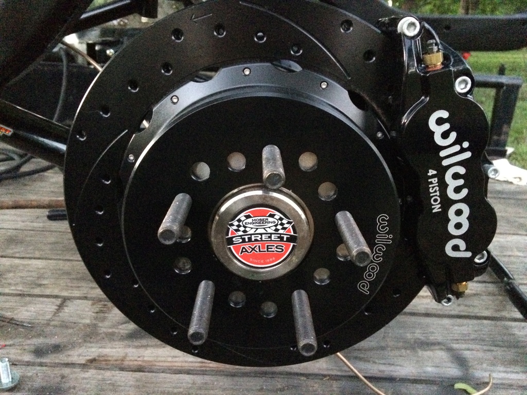

Here are a few pics of the brakes. I need to take another one of the master cylinder and proportioning valve set up.
It's funny that you have to cut off all of the stock brake mounting points from the spindle so you can put brakes on.

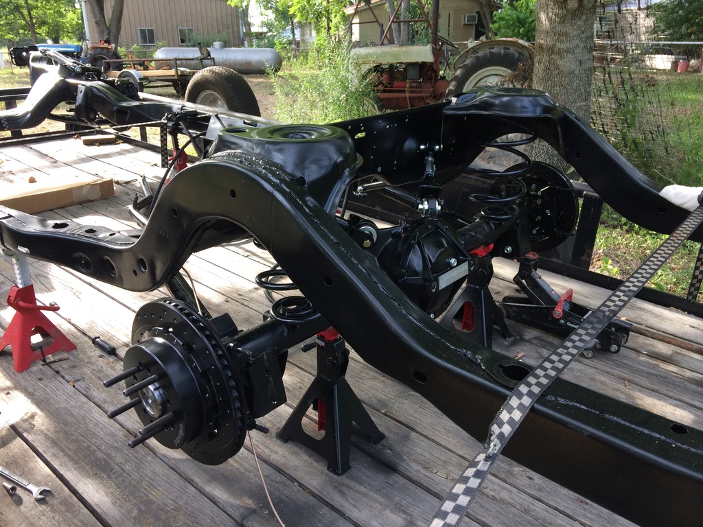

I flipped the frame over, by myself, and started finishing the paint. All of my Global West suspension items are in now so tomorrow, because today is my daughter's 14 th birthday, I will install some pieces and get this thing complete. Hey Bill, I might name this frame after your old girlfriend. If you want you can come take a video for your youtube channel. All of my rear end stuff should be here next week.

I had some time this week to do some work. I got a lot of the suspension installed and the front brakes. I got all of my rear end stuff in and installed all the bearings but I got stopped by not having the tools or know how to set up the new ring and pinion and posi. If I could have gotten that done I would have come close to finishing the rear of my frame. Oh well, more to come... For some reason I can't post pics right now. I will try later.

Does that a-arm brace go to the bushing side of the crossmember? I thought they go to where you see the nut in that pic. This project is looking good.
- Street Cred : 53
Re: Where are you at picture
Thanks big red. Are you talking about the rear brace from the lower control arm? The instructions for that said to bolt them to the lower control arm and raise it up and drill a 1/2 “ hole and mount it. That puts it under the upper control arm mount. Seems like the only place it will go.
- Street Cred : 19
Here is the instructions. The ones they have for the 68-72 do go to the upper control arm bolt. These are different. They are 90 degrees on each end. These look like they are a little stouter because they bolt to the crossmember on one end. I think they should bolt to the crossmember on both ends but they don't. With the supports I added to the control arm mounts I think these will add a great deal of rigidity. Rigidity is a funny word.

A little more work. I was able to get the rear end set up with a guy today. I almost have it in the frame. Just one more control arm bolt to install. Kind of tuff fighting springs, control arms, jack stands, and a worn out jack on the back of a trailer in some 97 degree Texas heat by myself. I was bent up in every conceivable position and that last bolt would not go. More to come...

You need to get those springs compressed somehow so the bolt lines up. Maybe get the local high school football team to stack their weights on the frame.

Vicariously is another funny word. The more I jack up the axle, the more the frame lifts. I have straps working on straps. I’ll get it this afternoon. As fas as that road trip, yes I did and it was a pure hell adventure. I don’t know if I’m ready to talk about that one yet. Got the deal done though.

I'll let you recuperate before I get the hellish details of your road trip. As far as the control arm goes, try removing the coil and then hook up your control arm. If it's too tight to get the spring in afterwards then jack up the other end of the axle and it should fall right in.

Hey BRL, I hope everyone is OK with your family. I had just a little time to work today. I missed the cool part we had today. Cloudy and sprinkling. It was actually 83 degrees. Then I show up and it goes back to sunny and 96. Stupid weather man had to remind me that the feels like temp was 101. Anyway, I was able to get all the bolts in the rear end and work on the brakes. And, drum roll please, I put the Moser stickers on the axles. It felt like I had accomplished something big. Hey Bill, I need you to come over and have a bolt torquing party. It will be fun.
