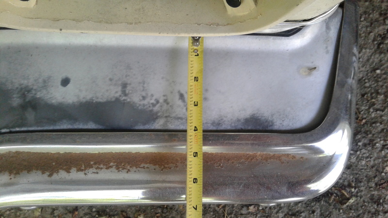

Re: 73 front bumper sink in - how far in?
Bumper shock is 7 inches long from front to back mounting points.
Bumper filler is 4 1/2
7 inches from front edge of bumper to bottom of headlight.
This is on the 73 SS.
In the pic, the "7" is right on top of the spot where the frame meets the shock.
Last edited by Roadcaptain S3 on Wed Jun 28, 2017 8:08 pm; edited 3 times in total
By that Measurement I would say can only go 3 - 3 1/4" sink

Thanks Roadcaptain S3!
In the first picture on the bumper filler, can you take the same measurement in the middle of the grill.
After can you look arround the bumper and imagine sink it 3 inch if it's look safe for the fenders?
