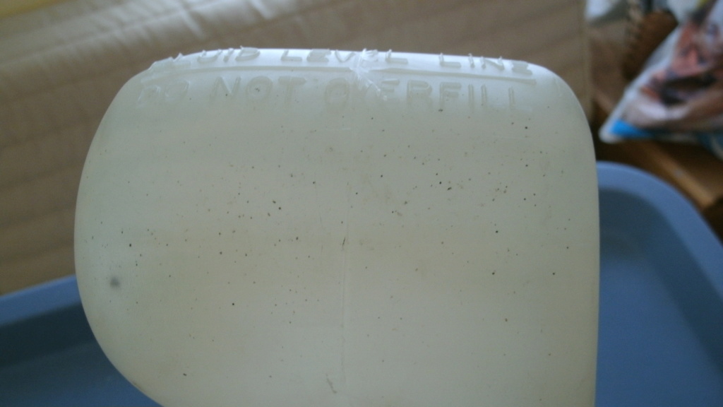

Going through some stuff and came upon this washer bottle.  Caught my eye since its pretty white as opposed to my other ones.  Upon closer look, I see that it has a "fluid level line" on the front,  some side lettering that says "plastics and stampings" with the S's backwards and the number 231493 on it as well.
Anyone know if this is an original bottle or an aftermarket.  I have had to removed it from one of the 73 chevelles I've parted out.
If this is an original bottle, anyone know the application or years?

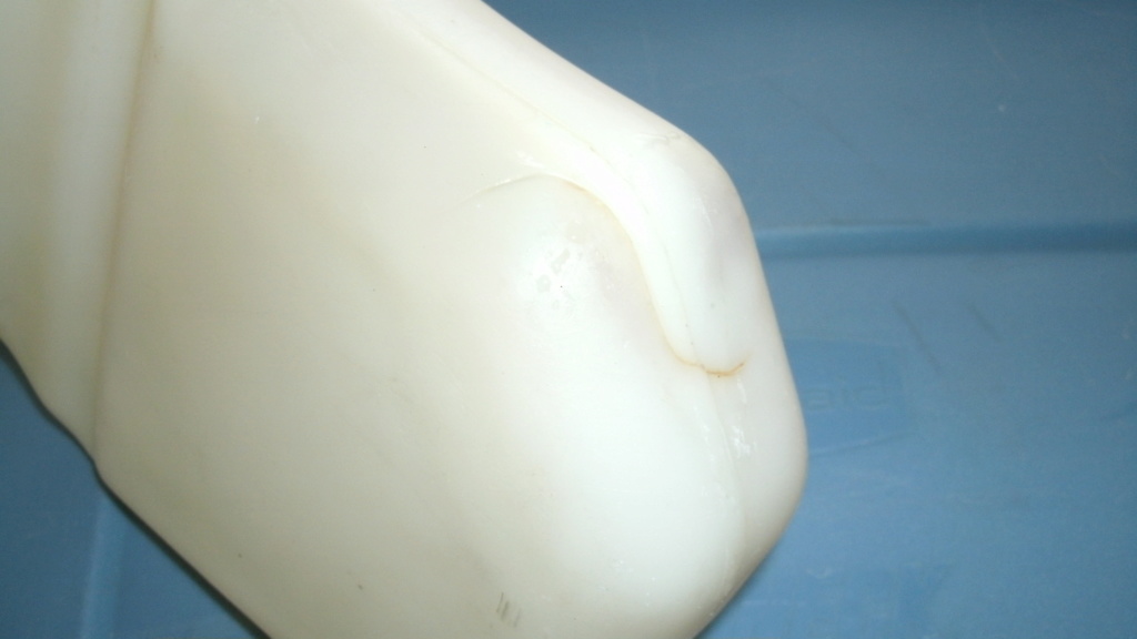

There is a small crack on the bottom but nothing some 3M 4200 or 5200 cant take care of and shouldnt be noticeable.

That's a good GM part number...and, is correct for all '73-'77 GM "A" bodies.

Have you ever seen those type of markings??

No, I haven't...and, I've removed a good number of them in the JY's. Maybe a re-pop?

Mcarlo77 wrote:That's a good GM part number...and, is correct for all '73-'77 GM "A" bodies.
It's not correct for a 73 Buick Century, Regal, or GS. The Buicks used an ugly combination white fan shroud with white coolant and windshield reservoirs mounted on both sides. I used one from a Chevelle on my Buick because it looks much better.

Hmmm...I stand corrected.
