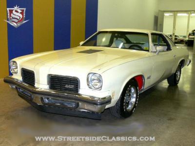

LOL, you're welcome 74442guy. I don't like the 75 442 hood, but the ram air looks alright. Either stick with the original or go ram air. Add the original to the poll. For some reason, I got a feeling people are voting for the 75 hood thinking that's the original one. Idea I vote for the scoops.
Scratch that. forget the hood & focus on making it launch like this:
opinion need for 74442guy Image13
Thumbs up Beer Thumbs up Beer Thumbs up Beer
Street Cred : 48

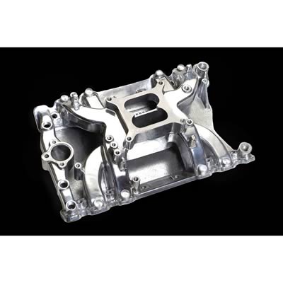

Limey wrote:no you just need the right combination of the right power adders dump the torker go with the performer, dump the street tires go with drag radial etc etc
Screw the Performer intake! That's not much beeter than a stock replacement. Torker is so-so, but get into this decade.
Professional Products Crosswind for BB Olds:
opinion need for 74442guy Pfs-57025_w

It's the intake I had planned to use on my 455 before times got tough. Lunati also has a Voodoo cam out for Oldsmobile. Newest cam technology available & designed for Olds, not a Chevy grind fitted to an Olds core. At least that's what I hear.

but the crosswind starts at 1500 rpm to 6500 and the torker at 2500 to 6500
whats bad about the performer ?? its starts at idle to 5500 would that not help his launch ??

IMHO, I think the Torker is softening his launch right now. Nothing is really wrong about the Performer, except he doesn't need to add low end torque. Judging by the traction problems, big cam, & deep gears a Torker or the Crosswind would be better suited. I like the fact that the Crosswind is new technology & is the ONLY high rise dual plane intake made for BBO motors AND it's an Airgap design.

To answer your question Limey, the Torker is a single plane, it's just outdated. If you want a single plane intake, you might as well go with a Victor intake. Of course, to get the most from it, you gotta fix the oiling problems & strap down the caps with a halo. Then there's the huge main journals to deal with.....
I really don't think the Torker would stand up to the Crosswind on either end of the scale. Look at all of the testing that's been done with the Performer Airgap stuff & how it always ends up within one or two horsepower of the single plane it is stacked against, but makes more down low. The Crosswind is basically the same thing. Here are a few things to consider:
1. The Crosswind is a high rise dual plane intake, the Torker is a low rise single plane.
2. The Cross wind is rated from 1500-6500, the torker is 2500 - 6500. Who has a better range?
3. The Crosswind has a nice air gap to supposedly keep the intake charge cooler.
4. Crosswind - computer designed modern technology. Torker - 1980's technology.
Maybe I'm biased, maybe I'm wrong. I just can't see an argument on which intake is better. Spend the extra $20 for a modern intake design & quit trying to build high end horsepower with a torque monster anyways, lol.
