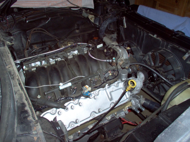

update:
I've been working on this like crazy, it doesn't seem to end.
The biggest thing is the wiring and making it all come together, but i'm getting there. here's some recent pics.
73 CHEVELLE SS PICS - Page 3 Chevel1173 CHEVELLE SS PICS - Page 3 Chevel12
73 CHEVELLE SS PICS - Page 3 Chevel13

Post by gpoetx on Sun Apr 01, 2012 7:25 pm
Think about doing this in a few months to my son's Laguna. How much modification was necessary as far as engine mounts?
gpoetx
gpoetx
73 CHEVELLE SS PICS - Page 3 Empty Re: 73 CHEVELLE SS PICS
Post by G3NUT on Sun Apr 01, 2012 7:47 pm
@Malicruiser wrote:What headers are those?
No headers. I ended up using the factory 98 camaro manifolds.
G3NUT
G3NUT
Post by G3NUT on Sun Apr 01, 2012 7:51 pm
@gpoetx wrote:Think about doing this in a few months to my son's Laguna. How much modification was necessary as far as engine mounts?
I used the factory motor mounts with a set of 1 inch set back adaptors.
I had to notch the frt crossmember on the pass side to clear the pan.
G3NUT
G3NUT
Post by jerry46765 on Thu May 24, 2012 10:51 pm
That body looks laser straight and that is a very tidy transplant.
Where did you hide the ECU?
How does it run?
What did you do to the motor as far as mods?
Thanks -
Street Cred : 20
Post by G3NUT on Thu May 24, 2012 11:47 pm
@jerry46765 wrote:That body looks laser straight and that is a very tidy transplant.
How does it run?
Thanks -
Thanks,
The ecm is mounted inside uder the heat box on the passenger toe board.
It runs and drives mint.
No mods yet it's bone stock. I'm going to pull it out this winter and go through the engine. heads,cam,intake etc etc. But for now i'm driving the hell out of it.

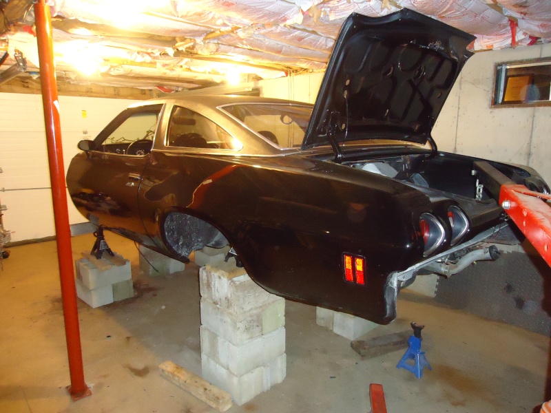

Post by G3NUT on Sun Nov 18, 2012 7:07 pm
I had a busy weekend.
Frame is out and new one is ready to go in.
73 CHEVELLE SS PICS - Page 3 13710
Post by Joe73 on Fri Nov 23, 2012 8:43 am
I see the engine hoist in the trunk latch area. How did you go about lifting the body. I usually lay a 9' 4x4 on top of the cowl and put some rope around the door hinges on each side. Then a 10' 4x4 slides between the top of the frame and the top of the wheel well. I just have three guys lift at the tail light area and another slides the 4x4 in. Then 2 guys on each side of the wheel well lift and slide some cement blocks or ladders on each side for the 4x4 to rest on.
How did you go about lifting it off? Thanks
