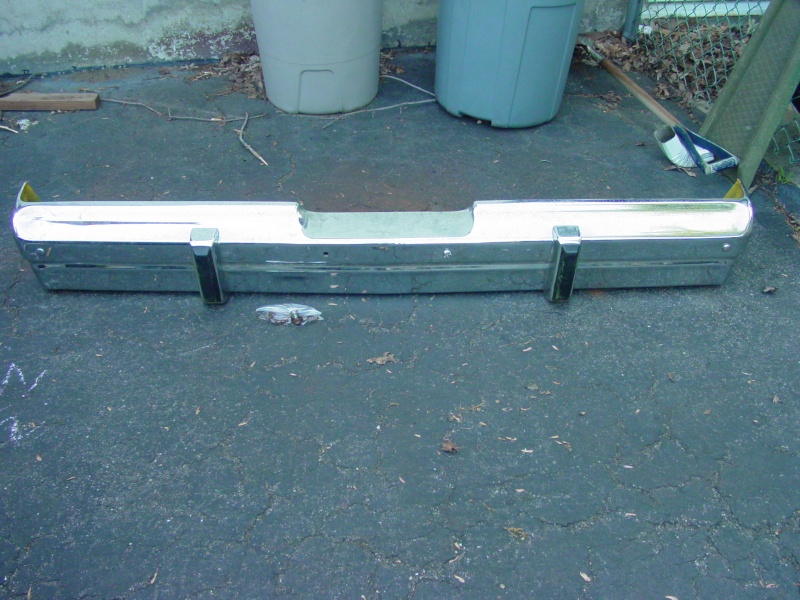

The bumper looks way different than my 77...what's the spacing of the bolt holes on yours?

74-5 are different than the 76-77. Later years are much bigger and boxier.

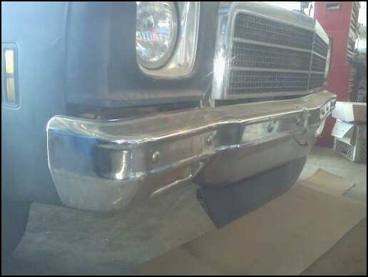

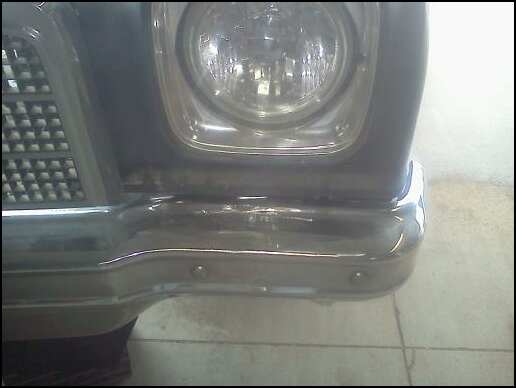

I took the bumper off the car removed the inner support, only enough to remount to rebound shocks.( not gonna see alot of street use, if so OWELL!) I found a relatively straight piece to mark my cut. Purposely where the bumper jack slot is. I cut the curved corner completely off. Reinstalled bumper(temporarily, where I wanted it positioned) I then took the cut pieces and slid them inside the place where I cut them at. Behind the cut end kinda inside the bumper. I then measured and marked with masking tape and trimmed off approx.1.5 inches from both sides. This got a little tricky, I enlarged the 4 slots that the rebound shocks mount to inner bumper to allow for slight adjustments. Ensuring bumper is centered on car, side to side. I tacked welded the corners back on to trial fit. Several times. Even trimming on the far bottom inside edge where bumper is closest to bottom of quarter panel. After I was satisfied I finished welding, then ground down welds. I have some cleaning up to do yet, but I'm still working on other mods.

The bolt spacing on is 11 inches for the 1 on each corner, the rest are 14 inches. Also I needed to trim the section in front of the flip up license plate, I removed about 1/2 wide by whatever the width of the plate is, to get to fuel neck.[img]bumper sink in - Page 3 77504212[/img]
