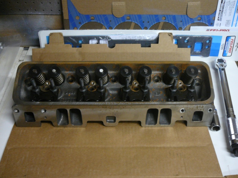

so great pull my valve cover off today and for the first time remembered to run the casting number came back as 305 heads on a 350 aint to happy about it but want to know more does anybody have any information

i positive the block is a 350 came out of a 72 pickup truck according to casting 14022801 is the head cast number came back as a 80-86 305 head
might be 601 because i couldnt see it too well but i highly dought it

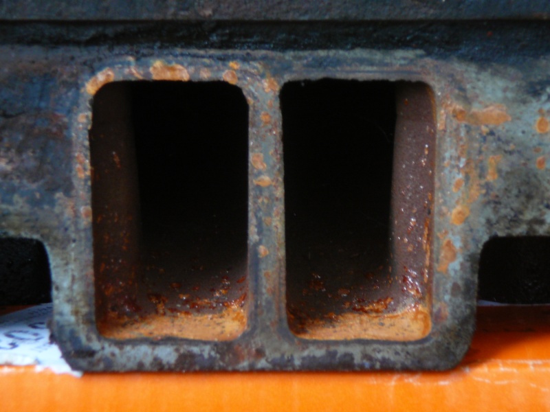

No experience with 801 heads, but seriously even if you pulled the motor out of the truck yourself you still didn't know about the heads. Who's to say someone didn't drop in a 305 years ago? The heads have 1.84/1.5 valves, which are decent for a 305, but tiny for a 350. I'm assuming since they are truck heads & not H/O heads that they are run of the mill stuff not capable of supporting a whole lot. They did bump your compression up though which should be noticeable. If you get a cam, stick with about 260-265 adv. duration or around 210-220 @ .050 if you want to be realistic. Any more & you are just wasting gas & not making more power with those heads IMHO. Carb should be somewhere between 600-650 cfm, keep the intake on the small side as well. A single plane is gonna run like crap on that motor. I'm assuming if it is a 350, then it probably has stock dished pistons or you would have noticed detonation by now correct? Probably in the 9:1 range depending on piston dish, gaskets, & actual head cc's (which should be in the 56-58cc range).

Try you might like it they have small chambers and that means a lot of compression. My friend needed a set on his Camaro so all they had at the machine shop ready to go were a set of 305 heads and the car runs strong down low so who knows.

yes but they have small valves, 1 point of compression higher is generally only 3.0% increase in power, but youll lose more than that in the loss of air flow. Keep 305 heads where they belong, on 305s

ya thats what ive been noticing thinking of swapping in a 400 figure the price of building the 350 be more expensive espcially if it has dished pistons

72 should have had a flat top piston and like black said the compresion you gain is killed by the fact you are in essence choking the motor
