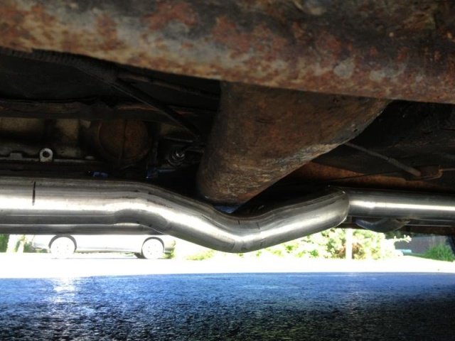

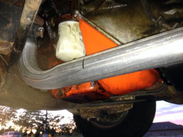

I wish I would have remembered to take a photo when the car was on the lift, but here's what I've cobbled together of my recent exhaust system rebuild.  Gone are the headers and hooligan side pipes (as well as the excess noise and heat) and in their place a proper exhaust routed to the rear of the car. They made a nice little bend to go under the trans crossmember and even installed a surprise h-pipe.  I'm using Flo-Pro mufflers and they give the ol' girl a nice growl.
They also replaced the engine mounts and that made a tremendous difference!  The ride is smoooooth and a lot of vibrations and rattles have gone away.

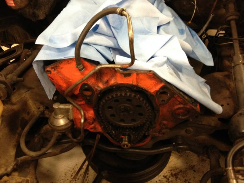

October 6: new camshaft installation begins. Within five minutes of delivery to the Northwestern Michigan College Auto Technology students, the hood was off and work began! A crew of two students is performing the work.
dhw3971
dhw3971
Re: '75 Chevelle station wagon project
Post by dhw3971 on Mon Feb 02, 2015 11:20 am
Time was not wasted tearing into the engine. I've removed the worn-out hood hinges and will send them out for a rebuild while the hood is off
dhw3971
dhw3971
Post by dhw3971 on Mon Feb 02, 2015 11:24 am
Cylinder heads to be removed, new lifters to be installed and valve job performed.
Floppy and worn-out timing chain (and gears) will be replaced. Fuel pump to be replaced as a preventative maintenance item.

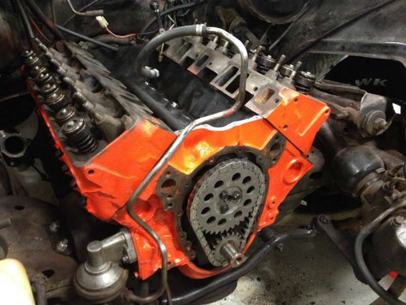

Post by dhw3971 on Mon Feb 02, 2015 11:28 am
One head off, one to go.
Head shows signs of valve seal failure...reasonable for a 40-year old engine with at least 150,000 miles. Heads will be topped with new chrome-plated valve covers with embossed Chevrolet logo.
new camshaft, timing chain/gears installed. Heads have been spiffed up with a valve job
