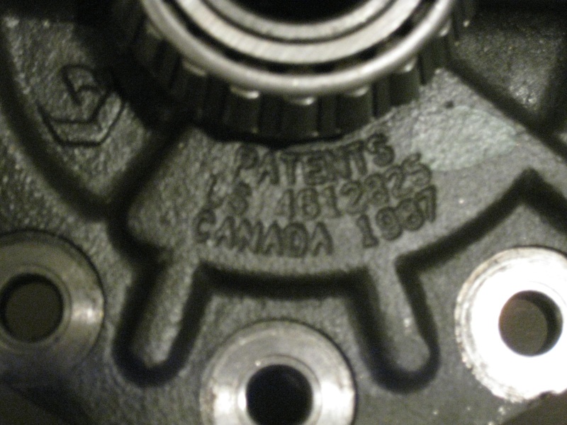

So what do I have here then? I bought this a while ago and was told it was an Auburn differential. After getting it, I couldn't find any info about it, like what gear lube to use, torque specs, etc.

I would count the splines on that and make sure its not a 30 spline. otherwise as I can tell its a late model (truck? or caprice) eaton posi. its a good unit ive got a couple on the shelf

The guy sold the axles to me also, I think they are Moser axles. He had wanted to use it in a previous gen a-body but his was an 8.2 instead of an 8.5.

bigredlaguna wrote:So what do I have here then? I bought this a while ago and was told it was an Auburn differential. After getting it, I couldn't find any info about it, like what gear lube to use, torque specs, etc.
Personally, I would stay away from Auburn Diff's. I blew up two of them when I was only putting out half the HP I have now.
