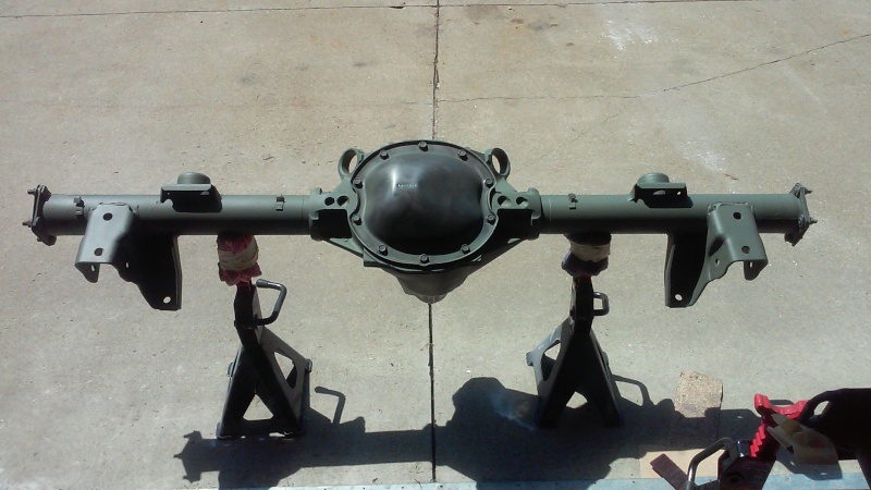

I am using a BOP 8.5 inch rear end under my 74 Chevelle. I am wondering if everyone else's LCA/Shock brackets look like mine. I am still trying to figure out why Lakewood insists that these traction bars fit my car, even though they won't bolt on anywhere.

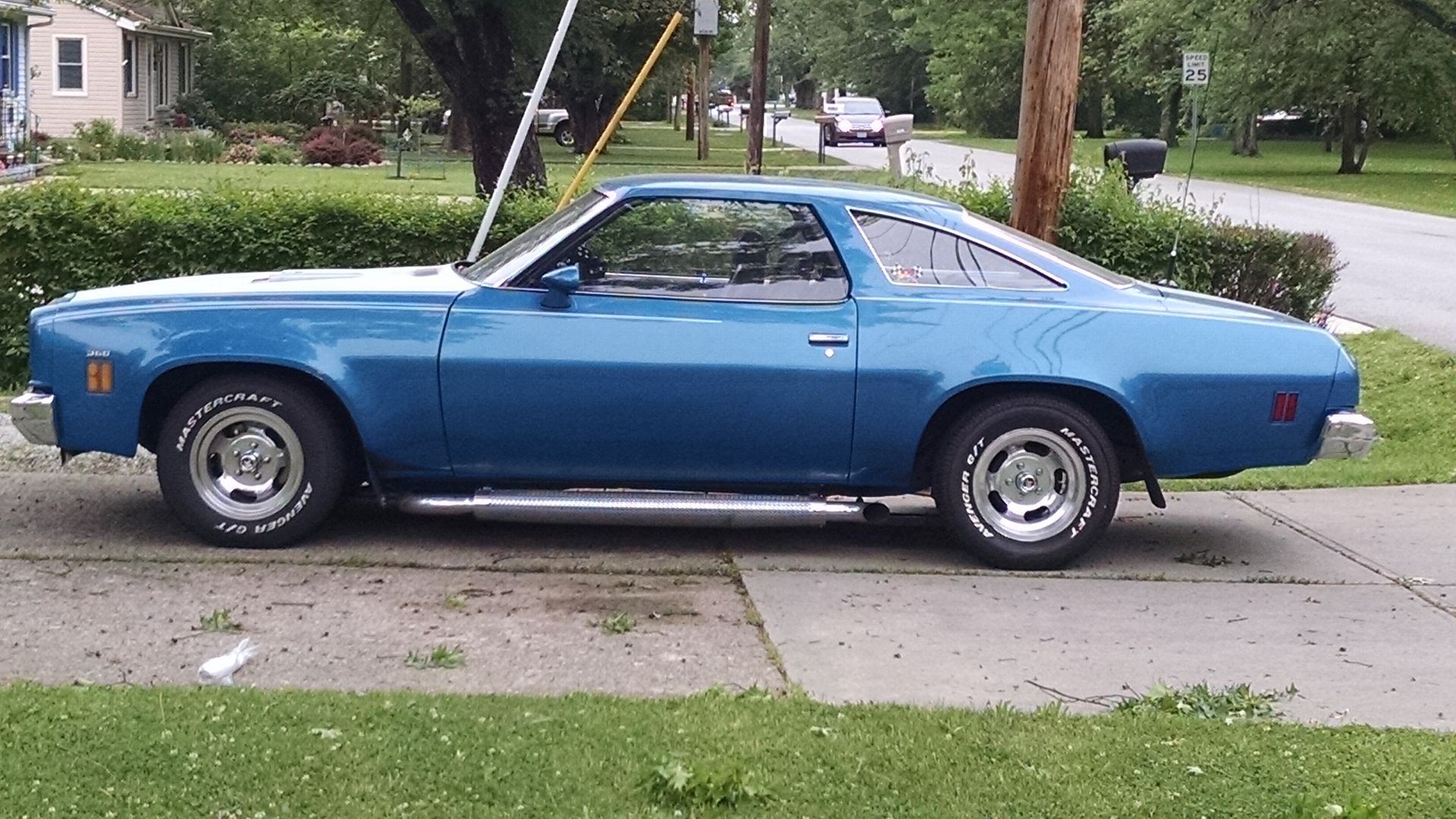

Post by dynchel on Tue Jun 02, 2015 1:34 pm
Traction Bars Anyone? - Page 2 IMG_20150601_145006481_zpsddpq4hqeTraction Bars Anyone? - Page 2 IMG_20150602_132924959_HDR_zpsdwdryjpu
Here's what mine looks like.  '74 chevelle note: I have relocation brackets welded below the arms...not OE.

Thank you dynchel. It looks exactly the same as mine, save for the relocation brackets.
