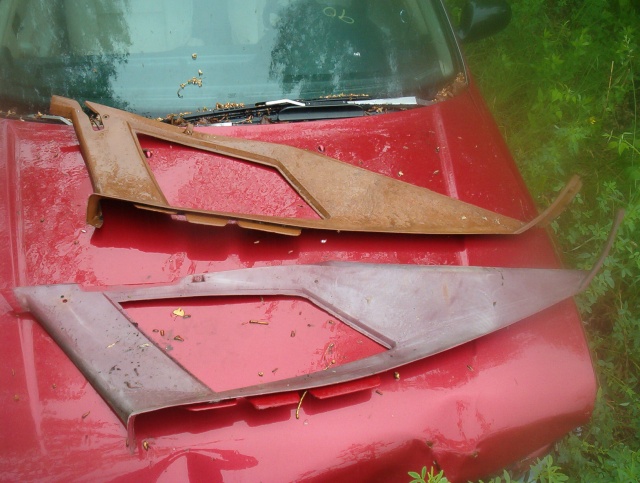

The one year only style of shoulder belts used on '73's were mtd a little further forward than on '74 thru '77. Here is a pic of RH side sail panels pulled from a '73 Lemans (top) vs '74 Lemans. You'll notice the seat belt notch at the upper left on the '73 panel. The wider opening on the '74 is located further to the right along the top. Otherwise, these would be interchangeable. This is typical of all the 2-dr "A" bodies.

Ah dang it. I was hoping that mine were not correct and i could put the 74 seat belts in my 73 chevelle. I have both panels and noticed the notch. Any suggestions; is it possible to upgrade to the 74 seat belt style? There also a complete 77 grand prix with buckets and center console.

Just don't know how you could do that and get the trim panels to work for you since it's so close to the leading edge. Besides, isn't the '73 shoulder strap retainer bolted in place with just one bolt...as compared to two bolts that attach the '74 retractor? There are brackets welded into the roof support to accept these bolts and it seems to me that it's just not feasible to switch from one style to the other.

Well i have the panels for both. My 73 has 2 bolts that bolt to the pillar where as i noticed that the 74 is higher more on the rough with 2 bolts. On my 73 in the same spot there what looks like the same shape of the belt retracter.
