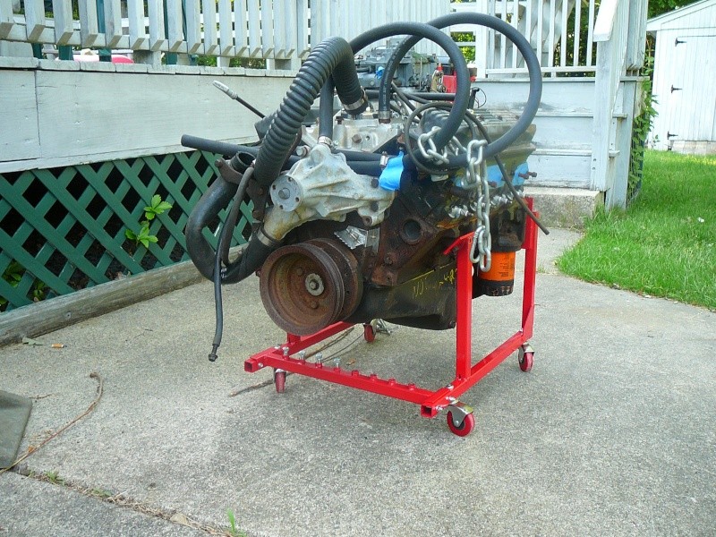

Best $39.00 I've spent in a while. I found this on craigslist here locally in Hudson, NH- brand new, manufactured by Atlas Equipment. The engine cradle is handy as heck- although the casters on this model are a bit wimpy. I'm going to modify it into a test stand/cradle, in the near future and get some better casters on it. There are similar ones avail through Summit/Jegs..etc.
Re: 1977 Chevelle Malibu Classic Progress Photo's aka Mali
Yeah those work great, I have three of em! A 350 on one, a locked up 283 on the other and a 250 straight six on the third one. Obviously the front mounts didn't bolt to the six, just put a couple blocks under the oil pan. I can still move em to get to my other stash of crap

I don't have any store-bought stands, but made a few, just to sit the engines on, no casters.. I have a Buick V6 and a Chev 350 on stands I made, and one for the big block Caddy engines.

Stinks not having a pick up truck...Don't laugh too hard, OK? LOL
Took me like an hour on Sunday to go about 50 feet from the driveway to the workshop. I calls it "Yankee Ingenuity" or Where there's a will, there's a way. On to some engine work this weekend

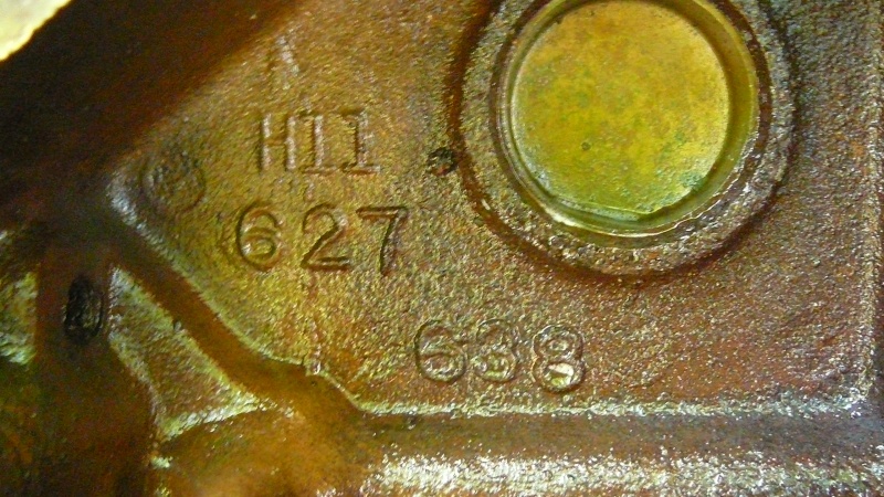

So this is the Engine assembly date code I think- bottom of block.
Anyone know what the heck this means? {H11 627}....on Rear of block on drivers side, upper left from the flexplate.

If it's a mid-late 80s block, there will be id number (like 10051184) on the machined surface above the oil filter housing.
Is it a one piece or two piece rear main seal?
Does it have a mechanical fuel pump provision?
Does the crank have a pilot bushing/bearing in it?
What heads are on it? Are they center bolt valve covers?
In reality, heads matter more than block ID once you know it’s at least a 350…
Since you know it's a four bolt main, it sort of defaults it to a truck 350 displacement if it is indeed from late 80s.
