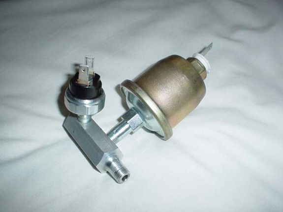

Post by 77mali on Wed Sep 14, 2011 7:53 pm
Found this one...Edelbrock is making them :-) Wooh Hoo!

Post by lagunainnewark on Thu Sep 15, 2011 3:46 pm
looks like you've found the hard parts. The choke coil connector connects to one side of the oil pressure switch. Connect the other side to a fused, ignition switch feed. Your choke will only recieve power when the car is running, this way it won't run down the battery, key on engine off. Ron

Mystery Solved
Post by 77mali on Thu Sep 22, 2011 7:50 pm
Ok...Mystery solved. Oil pressure sending unit it is with back up power supply that connects to electric fuel pump for some strange reason. (At least when installed on trucks). Might still work for choke too.
