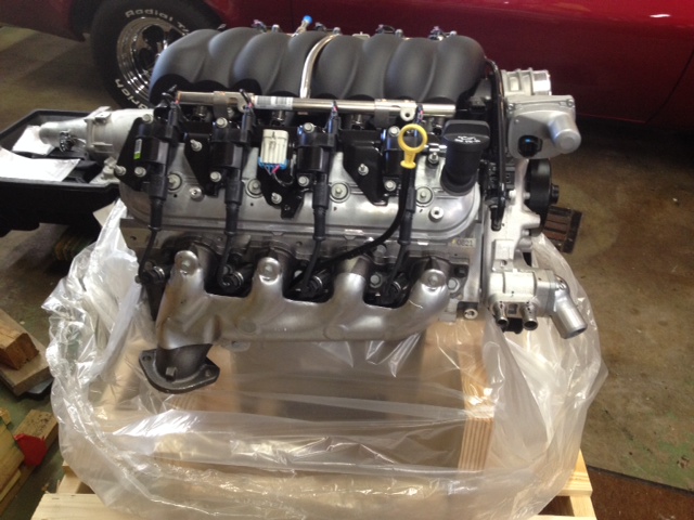

Well I know it’s been a while and if anything can wrong for some one that would be me. I got the whole engine and trany installed drive shaft shortened and all accessories hooked up just in time for car craft summer nationals in St Paul MN 2014. We limped the car in as I could not go over half throttle without it going into limp mode. The trany and engine are not communicating as they should or trany is sliping, But we made it in all weekend.
[url=Wallys 73 Malibu project - Page 2 Img_7120
From there I took the car to a very reputable tuner in my area for a hub Dyno tune to be done as that’s what the guy I got the set up from said its needs a tune adjustment. He had the car for a whole month and I would bug him every three days. He said he got it running better and to come pick it up. When I got there he said he had an accident test driving it and a rock hit the windshield. It was shattered nit just a chip. It was below the hood line just above wipers so I think he shut the hood on some thing.
[url=Wallys 73 Malibu project - Page 2 Windsh11
I took the car in to get the windshield replaced last Friday and barely made it home. The trany is slipping on every up shift even at low throttle and at wide open throttle it gets up ready to shift then stalls unless you lift off throttle like a stick shift would be then it shifts. The tuner guy did a line pressure test and it was good it has all 4 forward gears and reverse plus converter locks up. I called the engine guy I got it from and told him my situation and that I did as he said and got a tune done. He said to call his trany guy so I did. The trany guy blames the engine guy and said I would have to replace every sensor, ECM and wire harness and then he said or it just maybe in the trany. They both have now said I’m just the 1 in 100 the crap happens to and sorry I can’t help you. So much for that warranty, I have 120 miles on the set up all summer.
I got so frustrated and depressed over the whole thing that I said no more time or money is going to be spent trying to figure out what this guy did or did not do write. So last Saturday I went straight to GM and picked up a LS3 Connect and cruse 430 HP with a 4L65E trany with a 24 month 50K mile warranty. I plan to swap out the set up this Sunday.
[url=[url=https://servimg.com/view/17248508/392]Wallys 73 Malibu project - Page 2 Ls3_110
[url=[url=https://servimg.com/view/17248508/393]Wallys 73 Malibu project - Page 2 Ls3_1_10
[url=[url=https://servimg.com/view/17248508/394]Wallys 73 Malibu project - Page 2 Ls3_1_11
[url=[url=https://servimg.com/view/17248508/395]Wallys 73 Malibu project - Page 2 Ls3_1_12
[url=[url=https://servimg.com/view/17248508/396]Wallys 73 Malibu project - Page 2 Ls3_1_13

Ta Da.... Looks amazing. Can't wait to see it in the car. I am so sorry to hear about all of the trouble you have had. I hope things go smoother for you from here. Keep us posted!

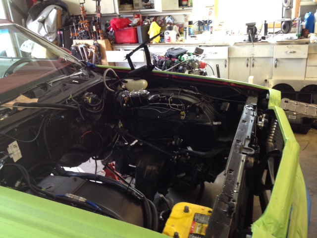

Well its in the hole an mounted just waiting on some trany line AN fittings and then pluming every thing. [url=[url=https://servimg.com/view/17248508/397]Wallys 73 Malibu project - Page 2 Ls3_in10

Post by driveit Mon Sep 15, 2014 11:56 am
Your still getting crazy with all that tape. Isn't it hard to get all of that residue off. Maybe I am using the wrong kind of tape, but everytime I remove tape from mine it still feels sticky. Anyway. Looks awesome in there. Make sure to take a video once you get it lined out!
Wallys 73 Malibu project - Page 2 Empty Re: Wallys 73 Malibu project
Post by Wallyuph Mon Sep 15, 2014 12:01 pm
There is 3MM blue painters tape down first then the 3MM Green tape over the 3MM Blue as its does not stick well when your up against it. Then not much residue from tape. If any I just use detail spray or in case of some heavy area a little adhesive remover on a rag wipe right off and its good for soap and water. With that candy paint you can not have enough tape on it.

Well the New LS3 is in and running. I have 58 miles on it. I just cam from exhaust place and have a Apt for next week to get 2&1/2" mandrel bent duals put on. Runs awesome.
[url=[url=https://servimg.com/view/17248508/402]Wallys 73 Malibu project - Page 2 Img_3410
I have a few little things like oil pressure gauge sending unit wont fit between fire wall and intake so I ordered a billet piece to install it above oil filter. Tach is not working so I ordered a painless Tachometer Adapter like I had to do on my laguna. Then I should be done.
