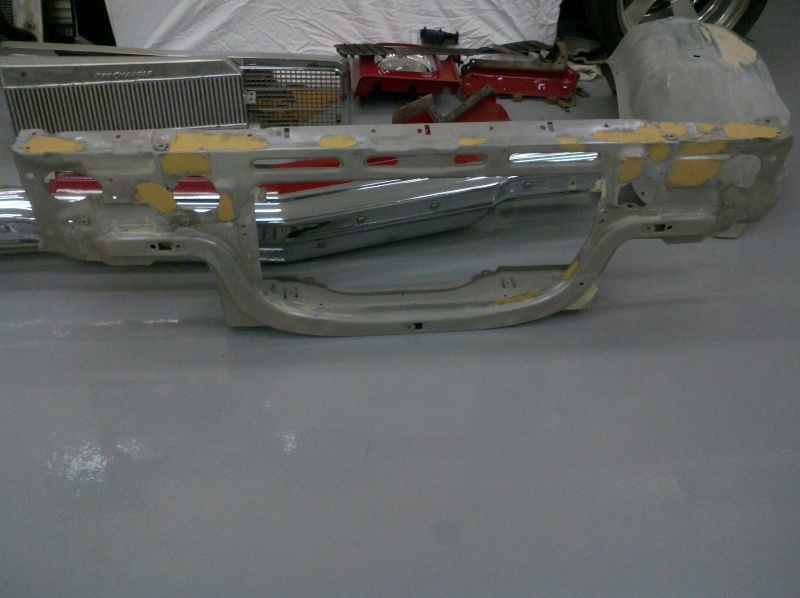

What can I say.... It's never fast or nice enough....
Sand blasted:
Little bit o' love... LOTS of holes welded up...
Can't believe the number of holes in a factory core support... Welded those too

Nice. If I ever tore my car down like that, I'd need a new core support
All rotted out around the mounts. One is almost completely through
