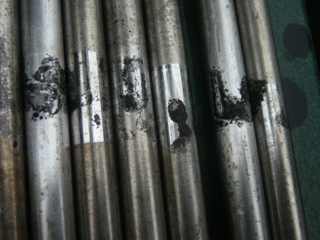

Are you tearing it down completely? You may want to consider examining the push rods to be safe. This is what I found after cleaning mine up when I did my top end over. Some of the corrosion was pretty deep. Good time also to look at the condition of the lifters.

The truck has roller cam and lifters.
