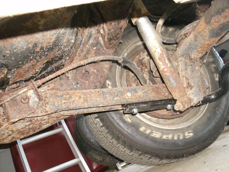

That pic is of the rear bars, the V shaped one is the OE for the 73-77 cars and the M shaped one is OE for 77-96 B cars.
bolt in like they belong there to begin with.
Here's mine with the 96 9C1 rear bar on it. It's kind of dark but you can see it in place.
