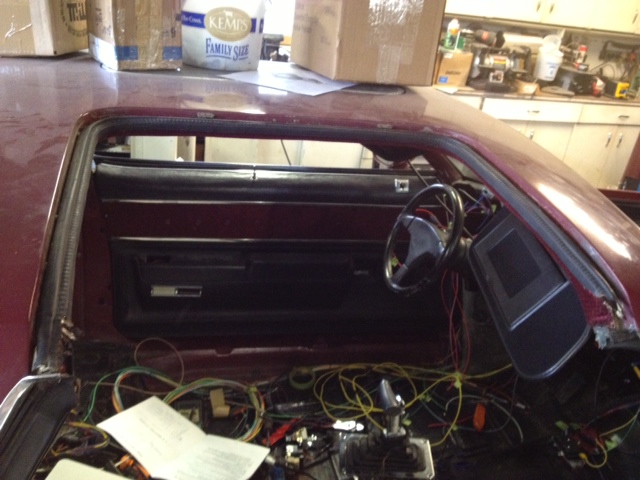

Dynchel was correct the roof was grafted on off a grand-am. They built there own steel frame opening and the T-tops sit in that opening. I was told from the guy I got it from that the person he bought it from stood on top to show him how solid it was. They are first Gen T-tops so there is no "frame around opening in body"
Wallys 74 project - Page 5 <a href=Wallys 74 project - Page 5 Photo_11" />
I did not do any thing to the body of this car. Its just the way I got it for body. I will say they did a good job on the body. the wheel wells are spotless and the one car is rust free. It had most of the stuff done when it was in Colorado in the late 80's. The car then went to Illinois were it sat for 8 years in a garage tell I got it.

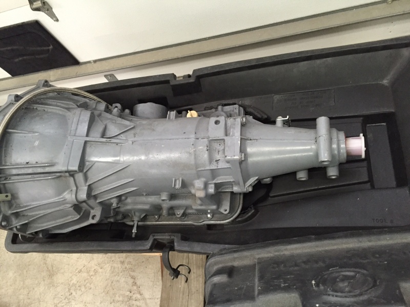

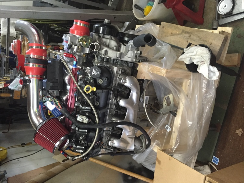

Update on Exhaust manifolds. I do not have them any more. I have a set off 5.3 truck and a set off ebay that said they were F body but with my set up so far forward they only cleared on drivers side. I then realized I sold them with the 6.0 I first had installed in my 73 malibu.
Here is the engine set up I sold 6.0 truck block with fast intake.
Wallys 74 project - Page 5 <a href=Wallys 74 project - Page 5 Img_3410" />

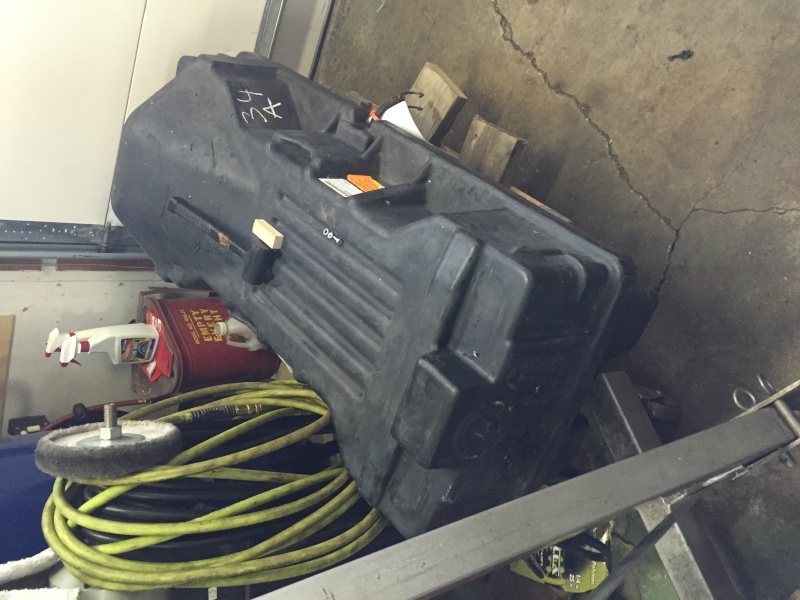

I do still have a rebuilt 4L60E trans with 200 miles on it. Needs a torque converter is what Dino guy told me. Its shifts all gears and has reverse. Just some time its like no converter is in gauged.
Wallys 74 project - Page 5 <a href=Wallys 74 project - Page 5 Img_5210" />
Wallys 74 project - Page 5 <a href=Wallys 74 project - Page 5 Img_5211" />
