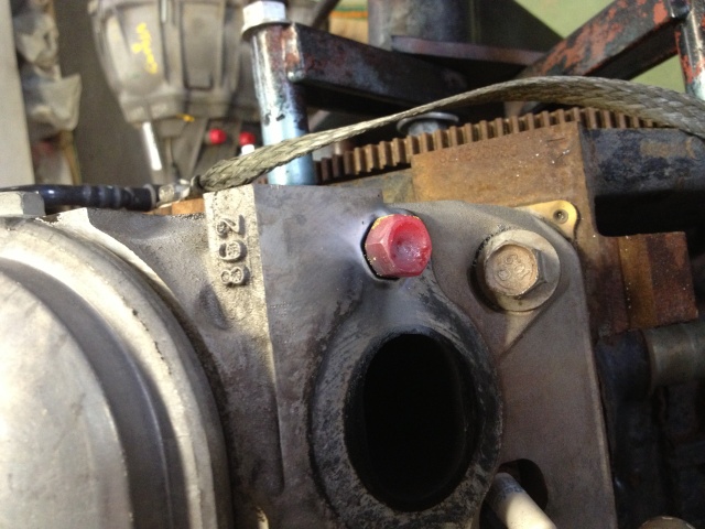

Don't you just love seeing this. A snapped off exhaust bolt in a Aluminum head.
[img]Wallys 74 project - Page 2 Snappe10[/img]
Then I snapped a easy out off in it. So I Figured I'd try and weld a nut on the snapped stud and easy out then unscrew it. It took 5 nuts to get it all the way out, as they would spin off and break weld. I found you need to let it cool completely before trying to spin it out with the aluminum head.
[img]Wallys 74 project - Page 2 Snappe11[/img]

I agree that you have to let everything completely cool before attempting to remove the broken bolt. But before I attempt the removal, I like to use a propane torch and heat the aluminum part a little. Aluminum dissipates heat quickly but still expands a little. Just to take a little pressure off the threads.

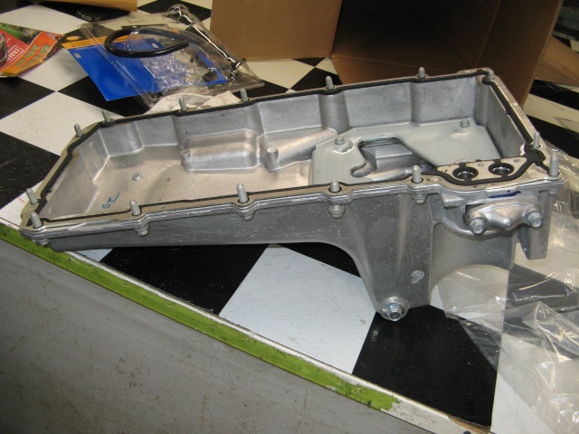

Summit oil pan
Wallys 74 project - Page 2 Img_6611
Wallys 74 project - Page 2 Img_6612
Wallys 74 project - Page 2 Img_6613

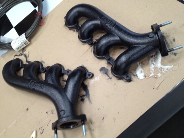

What coating on the exhaust mannyfolders?
Wallys 74 project - Page 2 Empty Re: Wallys 74 project
Post by Wallyuph on Wed Feb 27, 2013 9:40 am
I have a can of Eastwood ceramic black that I have had for 15 years. Its just about empty now as it was only a pint can. The good part is you can touch them up if they start to show signs of wear from heat. I got it when I did my 56 Chevy as I have cast iron headers from sanders on that one. Each spring when I take it out of storage is when you see some lite surface rust. I drive it home to get a good heat cycle on them then let it cool and touch it up with a paint brush. They smoke for a bit after it warms up but I like it.

The consistency of the Eastwood coating in your pics looks very similar to what I have & looks like it will actually hold up. Mine were coated w/ a 1200* Por15 product after grinding off a spray-on VHT hi temp ceramic that I tried out. I don't think the VHT coating would have survived one season.

Don't feel too bad, the ceramic on my Malibu headers is showing some small pits, and they don't have much over 1000 miles on them. Stainless steel type like built for Camaros etc would likely hold up for a long time.

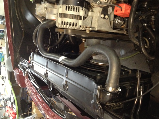

Woohooo. Sounds awesome! That gives me incouragement. I am still a couple weeks from firing. What did you do for the radiator to sit on? Looks like the truck accessory drive fits in much nicer than the ls1. I ended up having to get Holley brackets to move the alternator and ac compressor.
Great work.
michiganlarry
michiganlarry
Post by Wallyuph on Tue Mar 19, 2013 10:50 am
I used the stock core support and top plate. The new Rad came with the car so I have no clue if its stock for the 74 or not. But it fit right in just like my 73 does. It sits on the same rubber pads on the bottom.
Still do not know if hood will clear with the shaker hood cut out, but i know a stock hood with no cut out will not clear. The car intake is way lower than the truck.
I may have to move that steam vent and return hose to throttle body as cold air intake tube i bought for a truck passes right through it.
Where does those Holly brackets relocate the accessories?

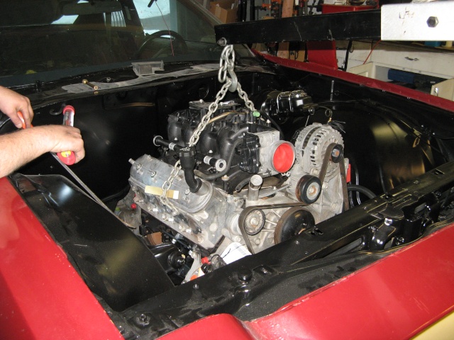

Here is a pic of my engine with the holley brackets
Wallys 74 project - Page 2 IMAG0849_zpsef60a09e
michiganlarry

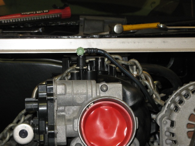

Have you put a straight edge across fenders to see if it will clear the hood.
Here is what I have for clearance and thats the top of the fenders so hood sits down in a 1or2
[url=[url=https://servimg.com/view/17248508/179]Wallys 74 project - Page 2 Img_6625
[url=[url=https://servimg.com/view/17248508/180]Wallys 74 project - Page 2 Img_6626
I'm told you can swap the intake from truck to car with the drive by cable throttle body but not the drive by wire as it will hit the upper rad hose nipple. I did read a post that one guy bent the outlet tube on the water pump to clear a drive by wire throttle body. Its not like the good old days of a short or long water pump. The blocks holes are interchangeable but not all the accessories.

Post by Wallyuph on Tue Mar 19, 2013 1:31 pm
Yes it does look a lot lower that the truck setup.
I'm as low as I can get it. Maybe a 1/4 gap from pan to cross member and the pan still hangs below the cross member. Your pan fits better and the one I bought was listed for retrofit's. I got it from Summit racing. Came with new pick up tube and splash pan. I will be welding a skid type plate on bottom of cross member when I get it deliverable.
