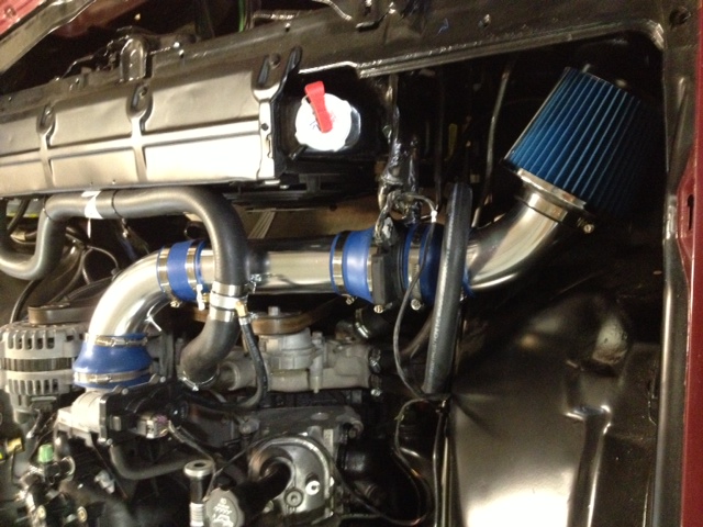

Here is a update as it has been a while since I have been able to work on it. I got the Body wiring done so All lights and turns signals work. Took it for a test drive to get some fuel in it. I have some running issues as it trips a Mass air flow code. But it's a dog off the line and from half pedal to floor makes no difference. Shift really slow between gears then bogs after shifts. Not real thrilled with tune the guy did for my stand alone ECM. It starts great and idols perfect. Now looking at getting my own software programing so we can start tweaking this thing. I did get it up to 95mph.

The scoop is just sitting in the hole. I need to decide if I should mount it to the hood or fab up some thing to mount it to top of intake. Need to get it running better first. Did some more reading and found that aftermarket Mass air flows do not always work as well as Gm ones.  I had bought a new one as I did not get that with my drop out set up. The only part I did not get. Going to try a Gm one next week and see what happens. If that does not help will need to look into software to reprogram ECM. Its the only code it shows. If you drive it like a "old man" its fine .

Post by Wallyuph on Fri Aug 09, 2013 8:32 am

Looks great! The only issue with those, though, is that all that metal tubing gets pretty hot. If not insulated, the nice cold air you brought in will pick up significant heat as it travels to the throttle body, thus negating the benefit of the cold air intake in the first place. I had to wrap mine with insulation, which worked, but then it looked like crap.Rolling Eyes

Mine will just be for looks. The hood was already cut when I got the car so just got lucky it will clear the intake as truck intake are way taller than the car on is on LS set up.

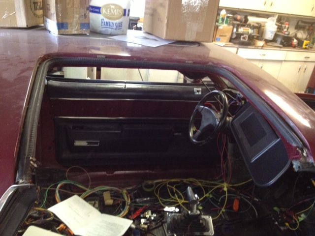

No its just sitting there for now. Working on getting it running better then will get little things finished up. I have no dash yet as I will making my own again. I have a Vintage Air with defrost to mount then build around it for the dash. So I have all my dash wiring just zip tied up to lower windshield. I used my GPS for a speedo so would not get a ticket for test runs.

That's what I was told. I did some research and I believe they were the first Generation of hurt T-tops as they do not have the metal frame around the opening. I was told the guy who did it Welded in steel all around to reinforce in. If you pull one out there is two tabs welded in the roof that go in the T-top removable section. I think he cut them in him self as gaskets are just the normal non T-tops we have.
