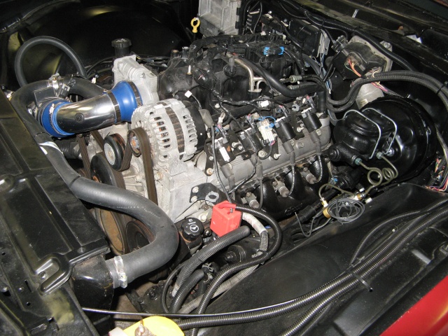

If you buy the Engine Mounts DD-62515L they will clear the cross member but its really tight if you ever needed to swap the compressor out you might have to lift the engine to do so and there is no slide adjustment as the mount is up against the A/C compressor with less than a 1/4" gap. It also put the engine forward quite a bit in the compartment. In this photo you can see how we had to shim them to get it to clear the Holley oil pan I bought from summit racing. ls1 swap in my sons 75 - Page 4 <a href=ls1 swap in my sons 75 - Page 4 Img_6610" />

I have this  lower profile oil pan on the new 6.0 I'm putting in my 73 Malibu it has a lower profile then the Holley pan.
http://www.ebay.com/itm/221290787893?ssPageName=STRK:MEWAX:IT&_trksid=p3984.m1423.l2649
I bought this A/C mount for my 6.0 as its the truck accessory drive on the front but they also make one for the car set up.
http://www.ebay.com/itm/160851959318?ssPageName=STRK:MEWNX:IT&_trksid=p3984.m1439.l2649
I don't know where the engine guy got the front end accessorizes on the 6.0 I bought but they are all new parts and they have the alt down low on drivers side.
ls1 swap in my sons 75 - Page 4 <a href=ls1 swap in my sons 75 - Page 4 Wallys11" />

Wow. My engine is back a couple inches from yours Wally.

Yes that's the way it is with the low mount A/C for me it worked out great as the drive shaft that was new and came with the car fit prefect so saved me some funds.
It does not look that bad after you get every thing on the fire wall. here is some photos form today of it.
ls1 swap in my sons 75 - Page 4 <a href=ls1 swap in my sons 75 - Page 4 Img_7010" />
ls1 swap in my sons 75 - Page 4 <a href=ls1 swap in my sons 75 - Page 4 Img_7011" />
Here is the clearance for the A/c unit as best as I can get camera in there.
ls1 swap in my sons 75 - Page 4 <a href=ls1 swap in my sons 75 - Page 4 Img_7012" />
I'm going with these mounts this time around so will let you know how they work out.
It wont let me copy the photo for you.
