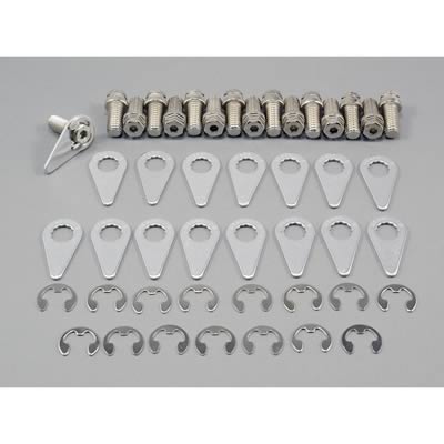

Post by Limey SE on Tue Apr 02, 2013 9:22 pm
Bruisr I used Stage 8 locking header bolts NEVER have had a loose one to the 9 years I have used them little pricey but sure beats tightening them up al the darn time
avatar
Street Cred : 86
Re: Header ID ????
Post by Bruisr on Tue Apr 02, 2013 9:30 pm
I've seen those and the split lock fasteners. I don't think they will fit all headers. I've noticed on some the head of the bolt is so close to the pipe, nothing will fit between the two. Even those shown above. Hence the warning, spend the good money on brand name headers. You will be happier in the long run. Personally, cyclone,blackjack, flowtech are the worst. Hooker or nothing for me. My hookers are over 15 years old and still going strong. HAHA!! He said Hookers!

Re: Header ID ????
Post by Bruisr on Tue Apr 02, 2013 9:37 pm
The last pic of the headers above, You can get the stage 8 fasteners on the #2 and # 6 pipe? It looks to me like the bolt would be too close to the pipe for the splined plate of the fastener kit.
