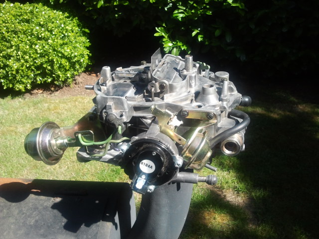

Here's the Quadrajet I built for my buddy and his small block.
[img][/img]
Gonna be a while before I can get it on the motor and tune it (motor still being built) but should be a good runner Smile

That's a beautiful job you did on that Sleddogg !! Very Happy

Post by Sleddogg on Sat May 04, 2013 9:19 pm
Thanks Smile
Here's to running as good as she looks lol
All good parts stuffed in there, everything cleaned out and spec'ed.
