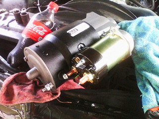

well sense my brakcet is on the header I put a 14MM socket on it to push the header back, it works!
and the new starter was a pain in the azz to put in with thoese bars and headers in the way.

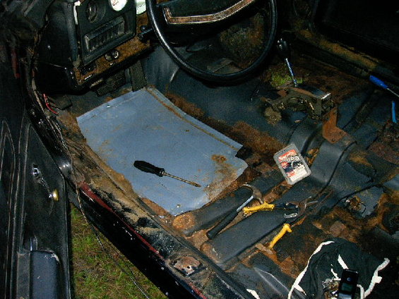

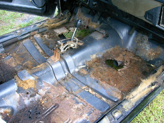

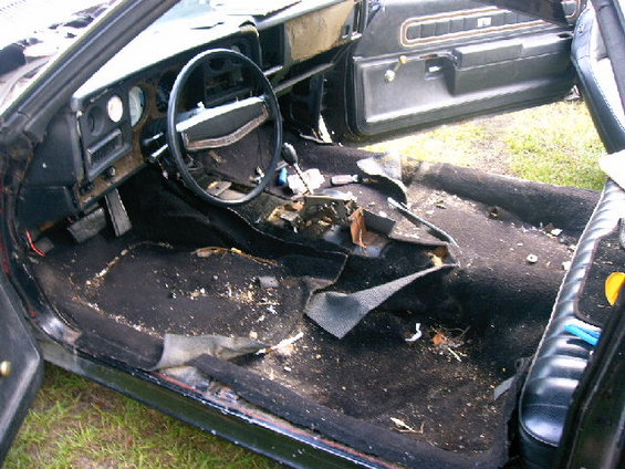

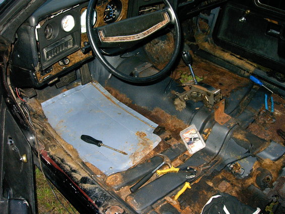

So i finally found a camera! so i can get better pics of my progress with my Laguna,
So I was trying to clean my carpet and found some HUGE holes in the bottom floor, sense I cant afford real floor pans at the moment we pulled some old sheet metal from a drawer..gotta get some more screws and some silicone to put around the edges to keep water out.

Post by thatfnthing on Wed Jul 24, 2013 10:56 pm
Wow, and I thought mine were rough...Shocked
