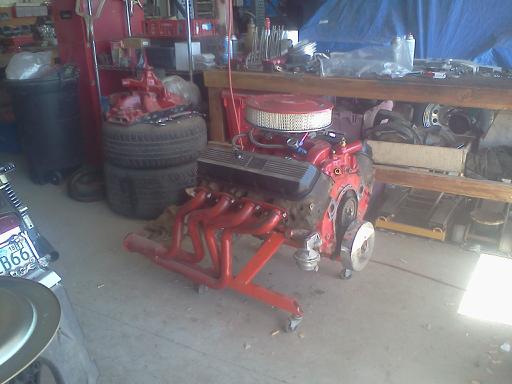

This is what the new engine will look like. I used a different 454 to mock up parts and paint scheme. However, I'm having a change of heart. I purchased an Isky 262 adv. duration cam with a .490 lift. I was going to keep it stock, now I want to bump up compression and run a bigger cam. I have the 750 double pumper, Victor Jr. manifold, MSD ignition, 3000 stall convertor or a 2200 stall, to go with the cam upgrade. I just can't decide on what size to go with. Thinking about a 280 adv. duration, something around .520-.550 lift. The engine has flat top, 2 valve relief pistons, heads are 353049 oval ports w/2.19/1.88 valves. Machine shop says compression is around 9.1:1. I don't believe him and don't have the tools to verify. I'm thinking its closer to 8.5:1. Oh yeah, heads have 122 cc chambers. Can anyone offer any suggestions or running something similar?

Sorry forgot to mention the heads in pic are not oval ports, there are peanut port heads used just for mock up, the oval ports will be painted to match the engine and intake manifold. I thought I'd try something different and try some red header paint instead of black for the headers. I only painted one to see what it would look like. Still undecided.
