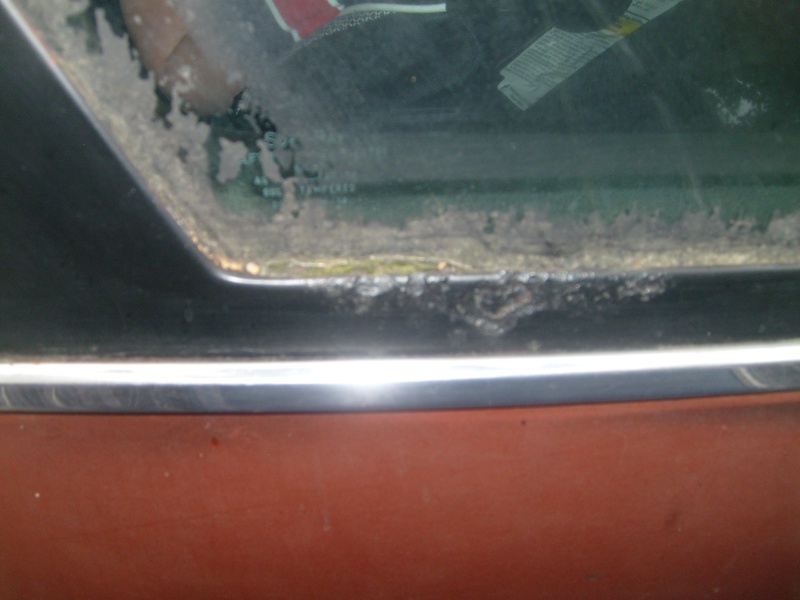

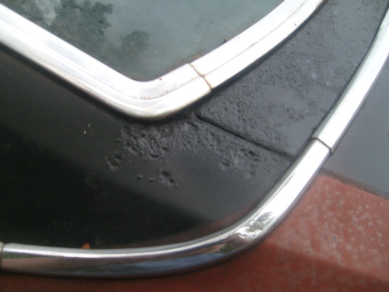

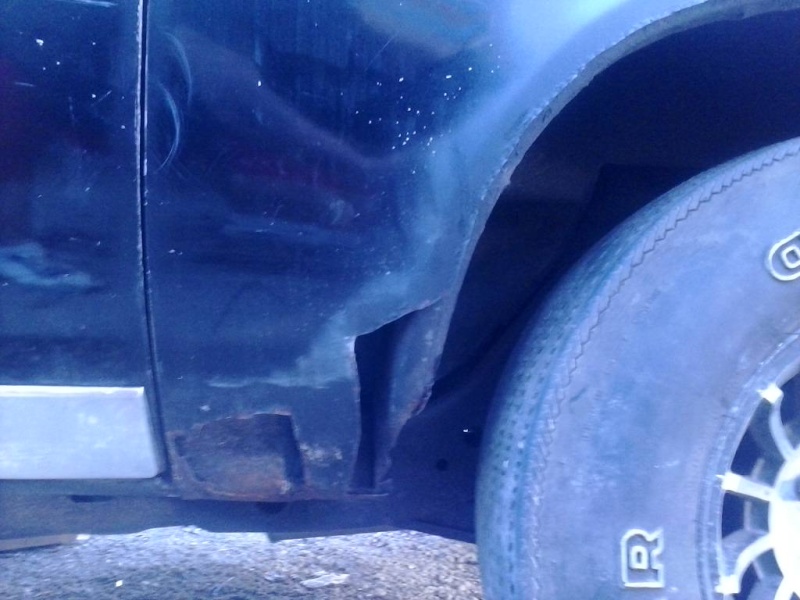

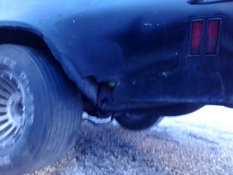

Here are a few pics of the things I have to work out on the car.

Previous owners awesome fix for the passenger qp.
Previous owners awesome fix for the drivers qp.
Rust around the rear window.
Top was cutout by previous owner. It's hard to see how wavy the top is in the picture.

You could always put on Lincoln roof like the Monte Carlo in the other thread. honestly it might be best to repair the roof to the best of your ability and reinstall a vinyl top.

The lower quarter panels would most easily fixed with a replacement panel (or a piece cut from another car)do to the compound curves involved. You could attempt to make a piece (weld it in). But leave it low to level with bondo, not the best way, but budget friendly.

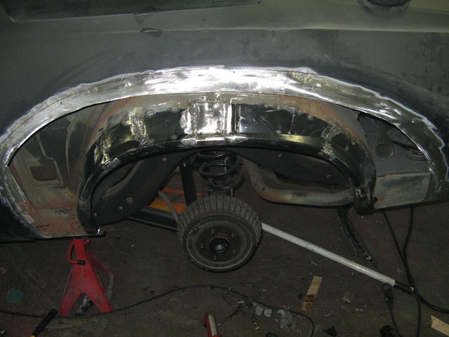

I actually used part of a Laguna fender:
This allowed me to keep the same wheel opening lines all the way down. I just flattened the panel out to follow the quarter panel lines and then welded it in.

My roof and opera windows have the same issue. I have a hole in the driver side quarter just at the lower corner of the back window and 4 rust bubbles around each opera window. Looks like these things have common areas huh?
