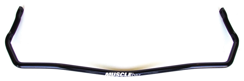

Front Sway Bar - RideTech MUSCLEbar Part #: 11249100 $500
Rear Sway Bar - RideTech MUSCLEbar Part #. 11229102
Front and rear shocks - QA1 Pro Coil-Over Systems GS401-10500C Summit $439.97/Free Ship

Do you think the products above are overkill? Would a factory unit be just as good as far as the sway bars?
avatar
Re: How to build an awesome handling suspension?
Post by dynchel on Fri Jul 05, 2013 5:46 pm
If your planning to run road courses, the aftermarket stuff is probably better. For street use the OE stuff works fine.
