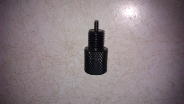

2) Do yourself a favor and purchase this cheap threaded bleed assist tool that installs in place of your warning switch during brake bleeding. This holds the inner valve shaft in the centered position until all wheels are bled. Then, just replace with the switch. Works like a charm...and, no more screwing around with centering it after bleeding the rears and then the fronts. And, no...air will not re-enter the system when swapped out.

Great info. Where do I get the bleed assist tool. Never seen one of those. Does it only go in hand tight because of the knurling? Thanks

Do you think you should use that tool whenever bleeding brakes? Think it would make for a better pedal? Where did you buy the tool?

Bought it on e-Bay for $10 (free shipping) from PerformanceOnline. It's made of Delrin plastic and yes, you hand tighten it.
http://www.ebay.com/itm/Combination-and-Prop-Proportioning-Valve-Bleed-Bleeder-Tool-Kit-Brakes-For-Sale-/160856168243?pt=Motors_Car_Truck_Parts_Accessories&hash=item2573c65733&vxp=mtr#ht_4122wt_917
I've never used one before when bleeding brakes...but then again, I've never done a complete system overhaul and having to purge all that air out of the system. And, from what I was reading, that's what will cause problems with the inner valve becoming off-center...is when you're trying to reintroduce fluid into the lines. Figured this would save a whole lot of time and aggravation over running back and forth from front to back to try centering a stupid valve. BTW, gravity bleeding didn't work worth a crap for me.
Don't know what to tell you about using one to get a better pedal...but, for $10, it's worth a shot.
