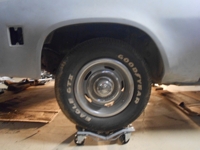

Post by bitterfitter on Sat Jan 18, 2014 5:53 pm
So I got time today after plans changed.  I finished the passeneger side and set it down.  Perfect!  3" lower....  I ended up cutting off 1 1/2 coils.
" />Here is the drivers side that is a good before shot...
" />Here is the passenger side after I took out 1 1/2 coils and put it back together.

After you set the car on the ground, it will still settle a bit more after you drive it around. I cut 1-1/2" out of my springs and it looked great until I drove for a day. Then it was too low for me, so I started over. It might be perfect for you though, so this is just a heads up notice that it might settle some more!

Pontichev327 wrote:After you set the car on the ground, it will still settle a bit more after you drive it around. I cut 1-1/2" out of my springs and it looked great until I drove for a day. Then it was too low for me, so I started over. It might be perfect for you though, so this is just a heads up notice that it might settle some more!
Settling a bit more would be fine with me. I was shotting for 3" or more just to be safe. I would not mind one bit if it goes down a little more. This was also with just one side installed. I still have to finish the drivers side to see where it sits when level. I just came in from working on it. The drivers side lower back bolt for the control arm was seized into the sleeve. After quite a few choice words, I cut out the bolt and moved on. I have the upper control arm instaled and the lower is in place with one bolt and a drift pin holding it there. I hope to get a new bolt soon and finish up the suspension. Then it is steering time. I am on the fence about replacing my gear box. It seems to be damp in a few spots. I would love to get into a quick ratio box for little cost though. Hate to spent big money on a new one. Mad
