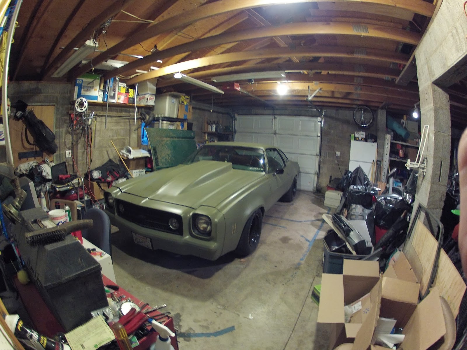

in the garage, GoPro pictures.
1973 Laguna, Project: Brutus GOPR0002+copy
1973 Laguna, Project: Brutus GOPR0001
1973 Laguna, Project: Brutus GOPR0004
1973 Laguna, Project: Brutus GOPR0005

Thanks 1973montec. Haha, the tape on the floor is the track outline from the mini RC races me and my buds would have when we were out in the garage drinking, we had a bunch of those Radio Shack mini RC cars. Childish, yes, but damn fun lol.
