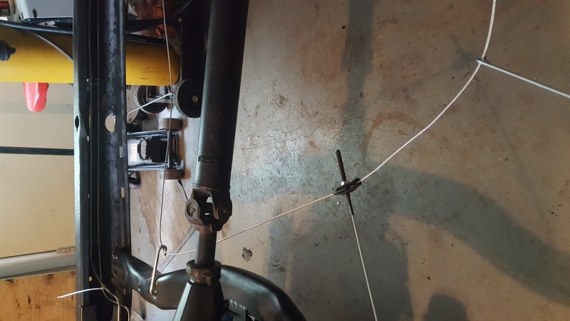

This morning I started messing around with the e-brake cable again. I originally thought the intermediate cable was too long. Now I believe it's actually the front cable. Unless I'm doing something wrong. I did find a cable that's about an inch shorter, but I don't think the inch will make a difference.
Here's the setup I have:

I see a couple things that vary from the stock setup. The cable hooks on the frame rail should both be the same length (about 9 3/4" lg) and should be hooked to bottom side of the rails at the round hole located directly below the body mount bushing holes. The crossmember hook should be moved to the next hole to the right (as seen in the photo). I do think your intermediate cable is way too long. As I said, mine measures between 96"-97".
You are correct in that there is a slightly shorter front cable available. I almost went that route as I am almost at the limit of adjustment with mine. But, seeing that it's such a p.i.t.a. to replace with the body on, I decided it's fine for the time being. Besides, I never use the emergency brakes on any of my vehicles.

Like this?
I never got the chance to see how this was before every thing was ripped about. I've just been guessing.

There you go. Now, you can maybe get some better understanding as to what you're working with.
