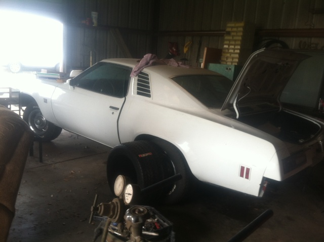

Hello. I just found this site. I looked for a Laguna to build for about 5 years. Well, now I have one. I picked it up a couple of months ago. I am now taking it apart to get it right. I bought an LS7 from a 2008 Z06. I got everything as in wire harness, A/C, computer, and, well, a lot more. I just bought my Soft 8 wheels and sent them off to Stockton Wheels for their upgrades. 17X10 front and 17X11.5 rear. I pulled the nose off and I am working on that now. My interior is being done in all black right now. I took the LS7 to a shop in Houston, HHRC, to install the Mast Motorsports cam and spring kit. So, I guess I am started on the path to getting a 1976 Laguna S3 back on the road. Cheers.

Post by REVINKEVIN on Sun Mar 23, 2014 3:07 pm
Some pics. Opps, I can't post images from external links for 7 days.

Post by Wallyuph on Mon Mar 24, 2014 9:33 am
Posting some photos for us from Kevin on his ride. Wally
Here are a few pics. A couple are of paint schemes I have been mulling over. I think I am going black to and white lower
