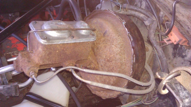

I've got too many things to do on my 'Guna to reinvent the wheel with my booster/master cylinder setup. When I completely went thru my brakes, I replaced the m/c with a factory std cast iron one (always go with a new one and not a remanufactured) and painted it with Rustoleum to keep the rust at bay. Pulled and tested the original Booster, cleaned it up and painted it, also. Looks good and I'm on to the next item on the list.
Before:
1976 Laguna master cylinder 75lagu11
After:
1976 Laguna master cylinder 75lagu12

Mcarlo77 wrote:I've got too many things to do on my 'Guna to reinvent the wheel with my booster/master cylinder setup.  When I completely went thru my brakes, I replaced the m/c with a factory std cast iron one (always go with a new one and not a remanufactured) and painted it with Rustoleum to keep the rust at bay.  Pulled and tested the original Booster, cleaned it up and painted it, also.  Looks good and I'm on to the next item on the list.
That came out great!  Did you blast the pieces first, or just sand them? How's it holding up against rust since then?

Post by Mcarlo77 Thu Apr 10, 2014 2:52 pm
The rusty master cylinder was the old one.  The new one was wiped down with degreaser and painted before installed.  Had to be careful to wipe any spilled brake fluid while bleeding/adding fluid to the system.  Booster was sanded, wire-wheeled (I swear I am responsible for half of Dremel's wire brush business here in Mpls.), primed and painted.  That was last summer and they still look the same.  Granted, I didn't drive it much before storing it for the winter.
1976 Laguna master cylinder Empty Re: 1976 Laguna master cylinder
Post by thatfnthing Thu Apr 10, 2014 4:00 pm
Oh, sorry, I misread it -- I thought that was the same unit, and I thought, 'Damn, that looks brand new!'
