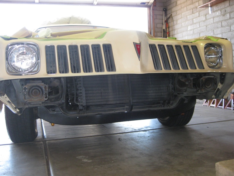

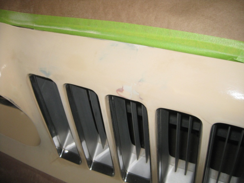

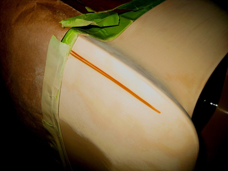

Well. I am trying to fix the cracks once again in the old urethane nose instead of getting a fiberglass replacement. The original owner had those pinstripes put on in 1983 and I am trying to preserve them while prepping the area around them for primer. I have about 1/3 sanded down and am starting to tape off the other side now. More sanding to follow. That is all...[img][url=https://servimg.com/view/17914608/387]Grand Am nose job Ga_nos11[/img]08]Grand Am nose job Ga_nos10[/url][/img][img]Grand Am nose job Ga_nos12[/img][img]Grand Am nose job Pavill10[/img]

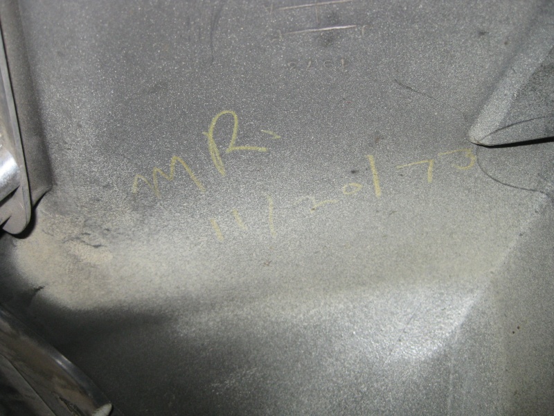

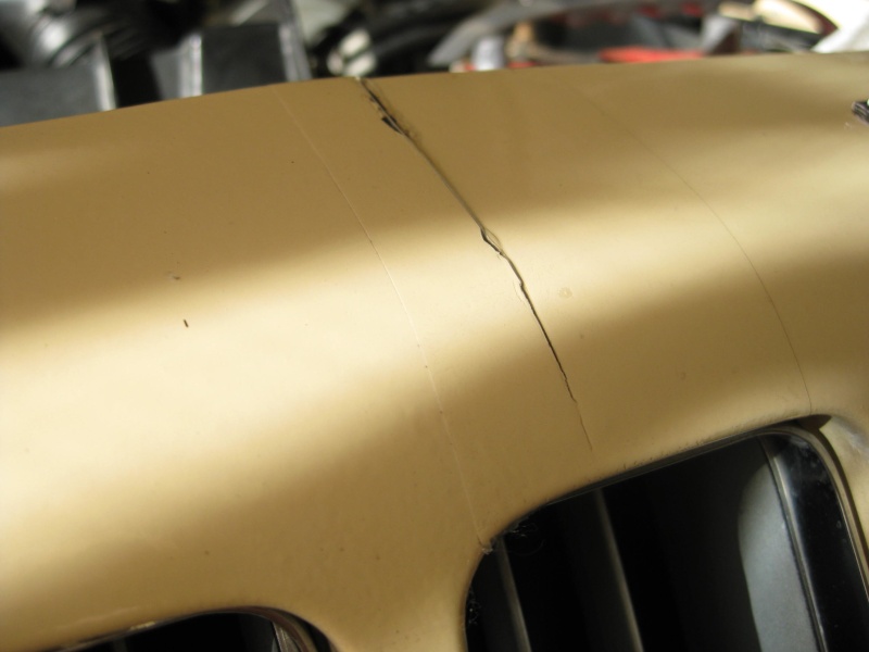

Well i made a few more steps toward getting the nose cracks fixed. Pulled off the "Park Bench" and tried to get the grills out, but even though only 4 screws hold them in, they also go thru the openings a little and won't come out on the car. So i gently removed the urethane nose and steel sub-structure and will try to ease them out now. While I had the nose off, I took pics of the tabs on the bottom of the nose that keep it from flapping in the wind on the fender bottom. One has been torn loose and I will have to fabricate a replica and mold it on. I also found more FACTORY MARKINGS!!! Inside the nose near the point is written in grease pencil MMR and a date code of 11/20/73. I love finding stuff like that!! It is too hot to keep working today, so I will attack it later.Grand Am nose job <a href=Grand Am nose job Grand_10" /> 2 Grand Am nose job <a href=Grand Am nose job Grand_11" /> 3 Grand Am nose job <a href=Grand Am nose job Grand_14" /> 4 Grand Am nose job <a href=Grand Am nose job Grand_15" /> 5 Grand Am nose job <a href=Grand Am nose job Grand_16" />

You can see how thin the urethane is by looking at the broken rib I'm holding in the grill opening. WAY different than a Laguna nose!
