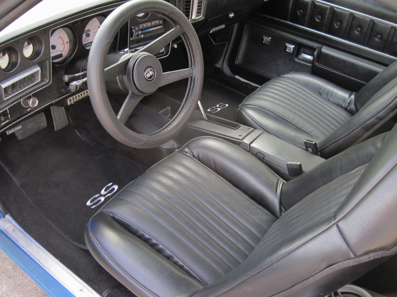

I watched the PUI video to get a better idea of how to do it. I noticed their upholstery kits are slightly different than the kit I bought in the way they secure to the bucket frame. The end result appears to be a more clean look than the PUI setup. I'm very happy with the kit I purchased from 1A Auto. From what I can figure out, the manufacturer of this kit is Quality Car Interior which makes most of their products in the U.S. I did have access to a steamer which my wife purchased several years back for cleaning bathrooms and such which helped in removing some of the wrinkles. The only other experience I have had with upholstery is when I got my seats back from the upholstery shop after installing the same kit for my el camino and they looked like hammered crap....almost $500 later! Below is a couple pics of that job. So I took them apart when I got them home and re-installed them the best I knew how at the time and the result is in the pics I posted yesterday. They look pretty decent for an amateur like myself. I would think most anyone on this forum with any kind of technical skill can do this install with a little patience. I certainly wouldn't pay a shop again to do this job since most upholstery shops have never seen these types of seats to begin with.

g3chevy - you look like a man who's taken these apart. How do you remove & reinstall the hard plastic cover from the back of the buckets?
thanks
75 Laguna Bucket Seat Upholstery Set Install Empty Re: 75 Laguna Bucket Seat Upholstery Set Install
Post by g3chevy on Mon Feb 09, 2015 12:36 am
When the securing trim is remove around the entire perimeter of the seat you will probably see a couple of small screws near the bottom front edge of the hard plastic covers. Remove the screws and you should be able to work the plastic cover away from the steel bucket frame. Hope this helps.

I meant how does the securing trim come off?
Post by g3chevy on Wed Feb 11, 2015 12:30 am
The seam for the securing trim is at the bottom front of your seat. There maybe screws in it as well that you will have to remove from the trim before prying it off. This may take a little effort since there are small metal clips that hold it in place around the entire perimeter of the steel bucket. Most of the clips will stay on the steel bucket frame so they can be removed after the seat cover is off. You will need to cut all the hog rings from the seat covers if you want to remove it completely. Hope this all makes sense.
