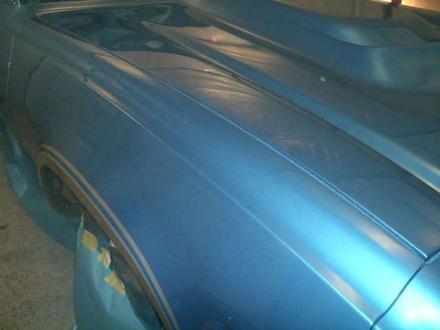

Post by Joe73 on Sun Oct 02, 2016 7:54 pm

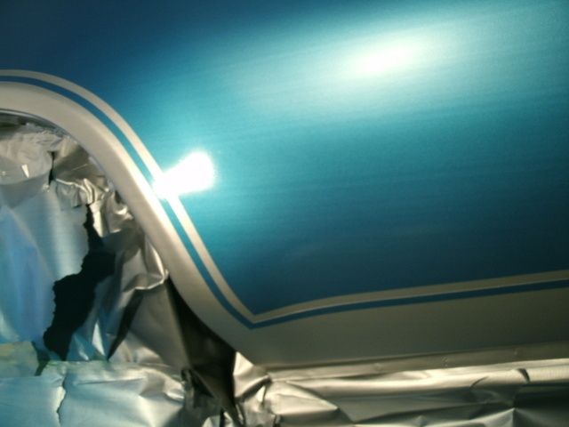

Ok, been working away at getting this car painted.  Spray booth worked like a charm.  I laid down 3 coats of activated Pro-Spray blue followed by a 4th coat to make sure my metallics are laying nice.
Almost 5 hours to tape off the stripes.  3 coats of pro-spray argent silver followed by a 4th dust coat again for the metallics just in case.
I let sit for 3 hours with the booth fans running.
Then I shot 3 coats of high solids polyurethane.  30 minute flash time between coats.  Laid out nice but I did get a couple sags which I'm not worried about.  I'll probably let this set up til thursday at which time I'll block the whole car out with 600 and shoot 2-3 flow coats of clear.  That will really bring up the shine.
Very happy with the results.  Here's some pics.  Limey, you asked for color, so here it is.  LOL

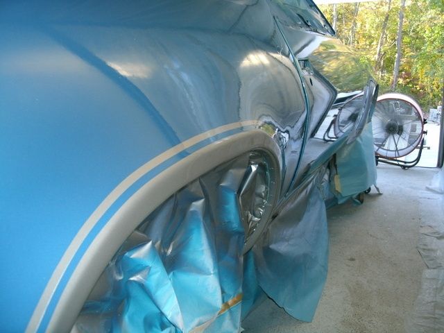

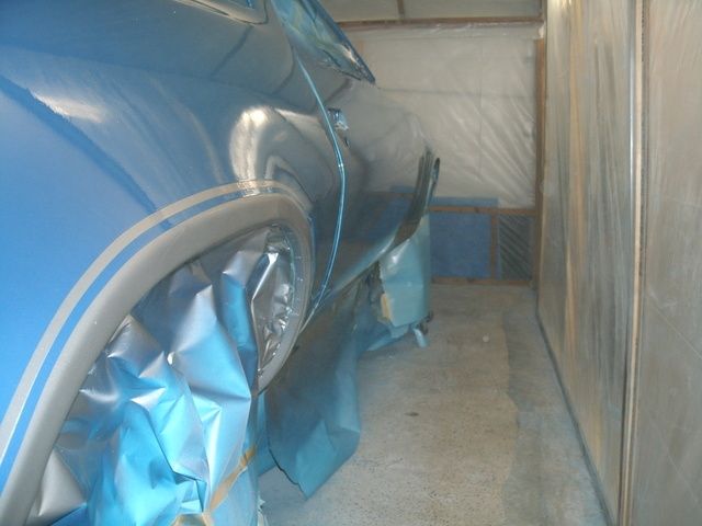

Post by Joe73 on Mon Oct 10, 2016 5:22 pm
Ok, quick update.  I wanted to get 3 more coats of clean on the car.  So a day and a half of block sanding and it was ready.  Paint laid out nice and a lot wetter looking.  Probably will wait til spring to cut and buff.
Here she is yesterday.
1973 Chevelle SS, 350, 4spd. build - Page 7 Final%20Blocking%201_zpsulxhjysq
And this is today.  This is the paint all dry.
1973 Chevelle SS, 350, 4spd. build - Page 7 Final%20Clear%204_zps8iz00jhg
1973 Chevelle SS, 350, 4spd. build - Page 7 Final%20Clear%205_zpswk4opojn
This is the last of the body work.  I'm not doing this again.  LOL.

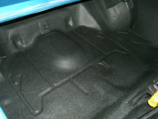

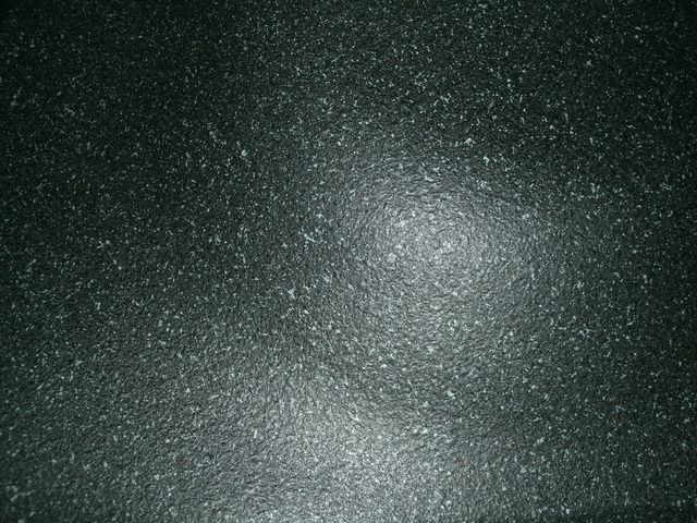

1973 Chevelle SS, 350, 4spd. build - Page 7 Empty Re: 1973 Chevelle SS, 350, 4spd. build
Post by Joe73 on Tue Oct 11, 2016 5:08 pm
Todays completed project is trunk spatter paint.  Zolatone Black/Aqua is what I used.  Dries hard and NO CLEAR COAT needed.  Great stuff.  You need a spray gun with at least a 2.0 tip.  A little bigger would be better.  My 2.0 primer gun did the job.  It dries quickly but Tech Sheet says 5-7 day cure.  Hoping to remount my G70 tire back on the rally and get it and the jack back into the trunk.

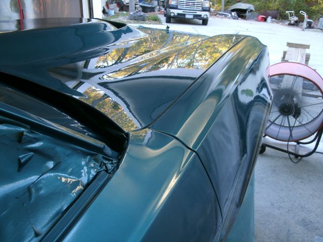

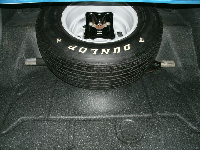

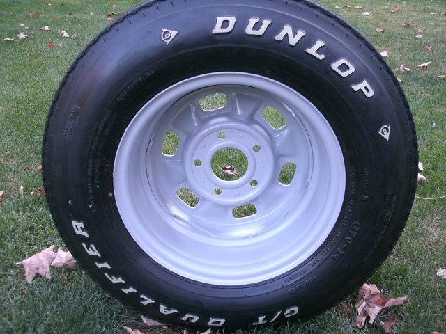

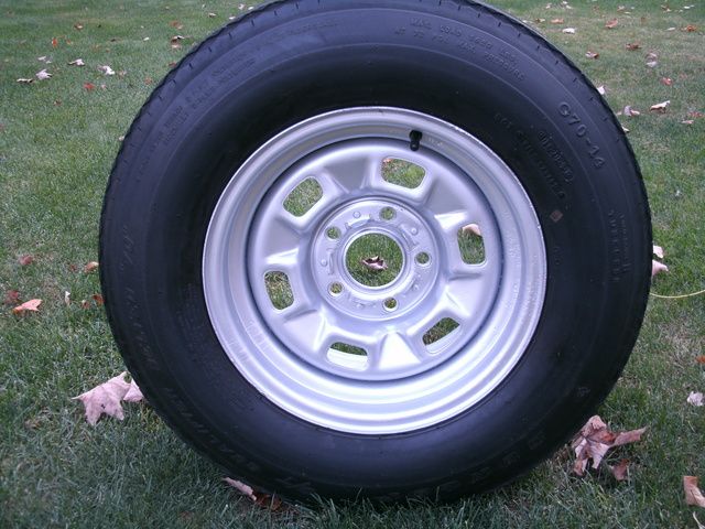

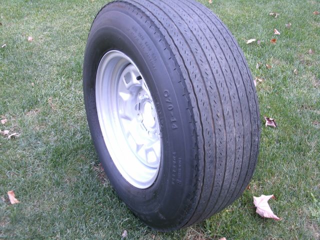

Post by Joe73 on Mon Oct 17, 2016 5:05 pm
Remounted the spare on the blasted and painted rim.  Installed in trunk with jack.
1973 Chevelle SS, 350, 4spd. build - Page 7 Spare%20tire%201_zpsw7fep61c
1973 Chevelle SS, 350, 4spd. build - Page 7 Spare%20tire%202_zps5jjrxwie
1973 Chevelle SS, 350, 4spd. build - Page 7 Spare%20tire%203_zpsbxiksuiv
1973 Chevelle SS, 350, 4spd. build - Page 7 Spare%20tire%204_zpsrgwxsm1a
