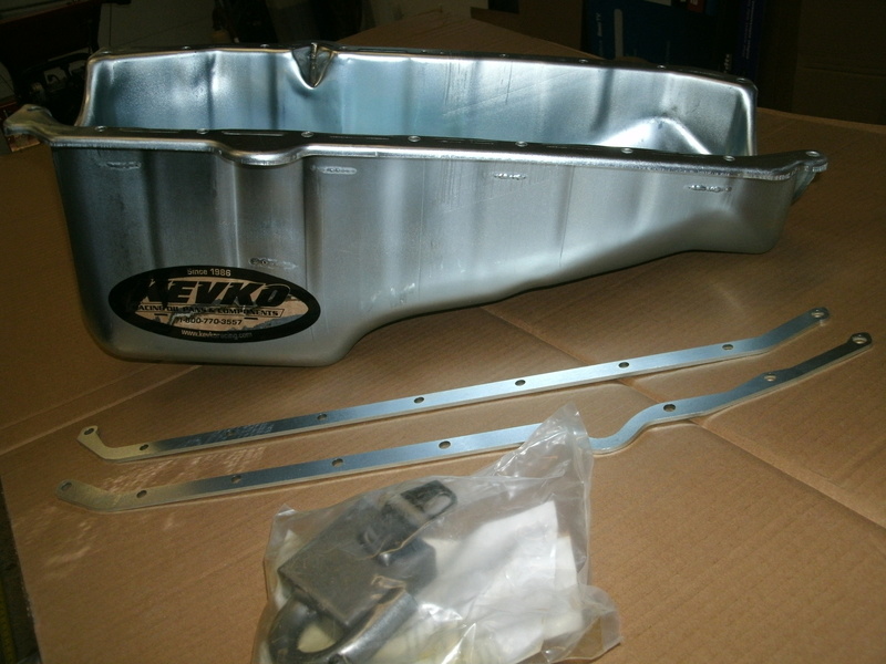

Post by Joe73 on Wed Feb 15, 2017 5:54 pm
Ok, just got my racing pan in the mail.  Pan is what Kevko calls a "stock appearing" pan with SCRAPER BAR, WINDAGE TRAY and (2) TRAP DOORS.  Windage tray is removable.  Also got the matching pickup for a melling high volume pump and BOLT SPREADER BARS.  Kevko said they weren't needed but would add extra insurance of no leaks.  Real happy with the quality.  Nice heavy weight.  Real rigid from the ribs on the sides. Welds are also well done. And only $95 for the pan.
Just have to decide whether I'm going to blast the pan and shoot some epoxy and chevy orange OR clean it up real good and shoot some clear on it.

Post by ant7377 on Wed Feb 15, 2017 10:02 pm
Nice Joe, sounds like a bargain too.

Post by jerry46765 on Wed Feb 15, 2017 10:33 pm
That pan is pretty cool and it looks like a sneaky stock class oval track part. Cool.

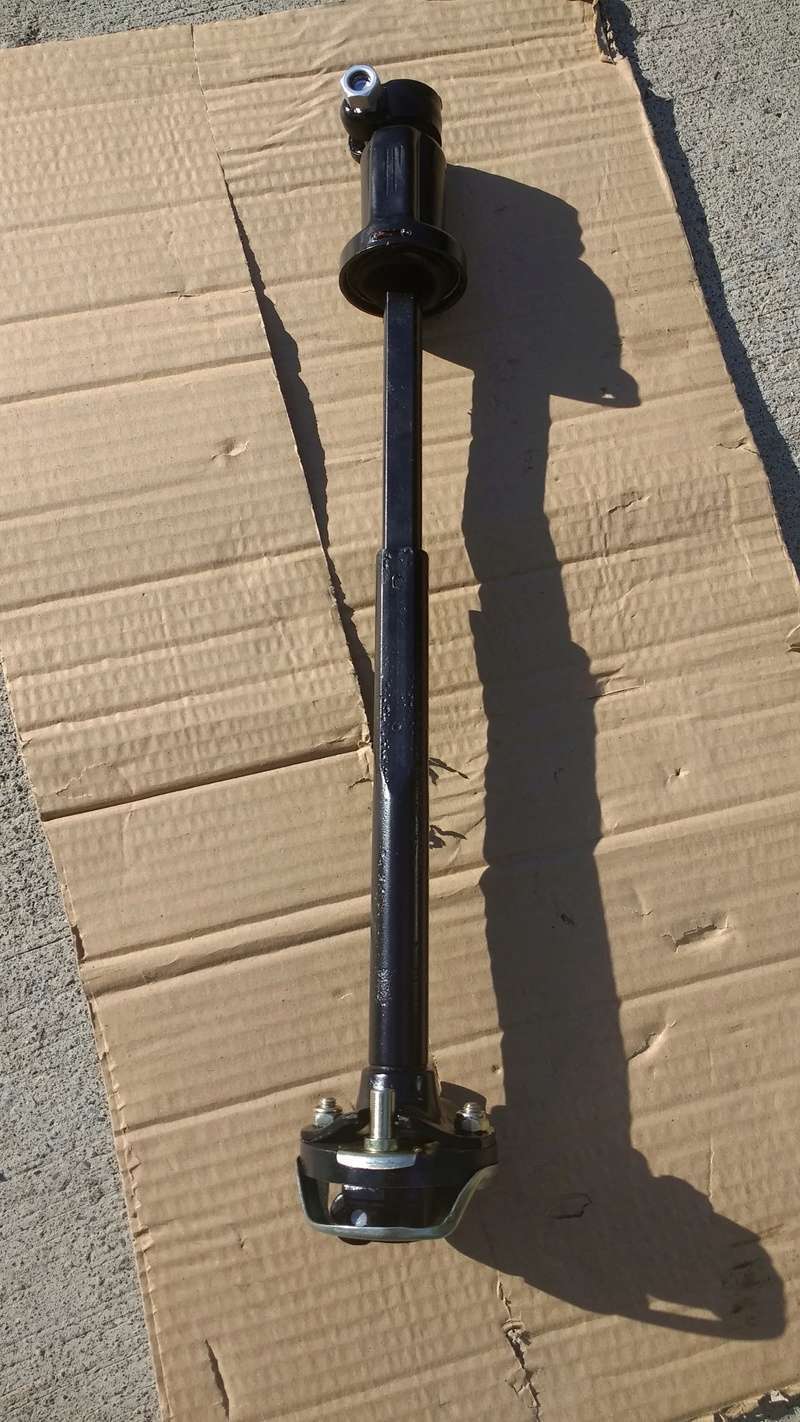

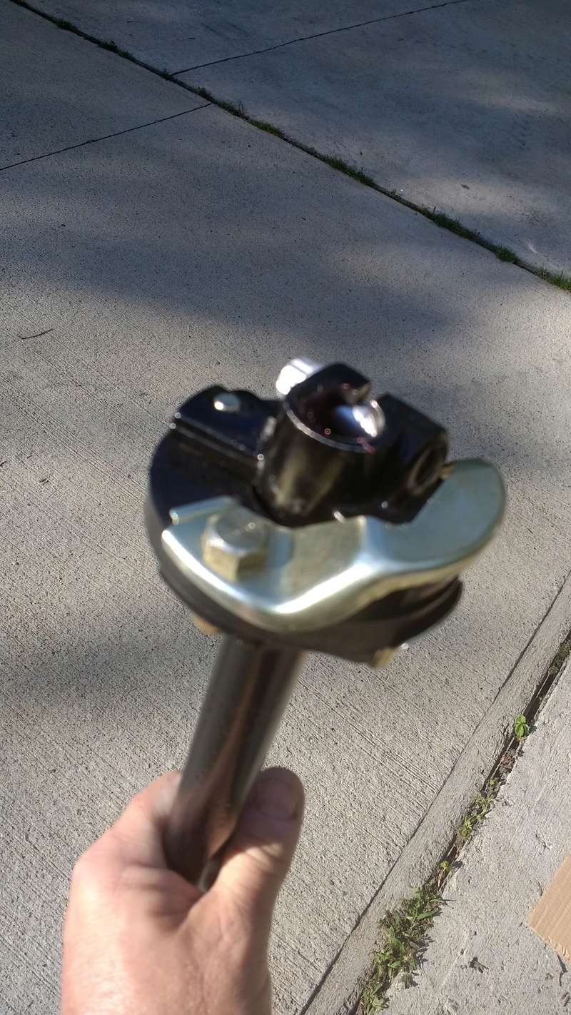

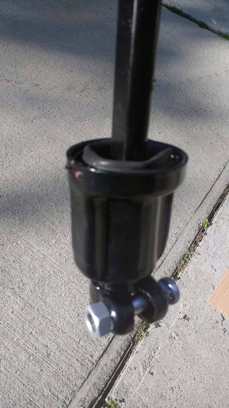

Post by Joe73 on Mon Jul 03, 2017 8:08 am
Had an itch to do something, but it had to be quick and I wanted to put my intermediate shaft back into my car after its rebuild.  Took it all apart.  Spring clip is real easy.  My boot wasnt ripped so I decided to reuse it.  I already had the new rag joint waiting in my box of goodies.  So off to the glass blast cabinet it went.  Came out nice.  Wiped it down with wax and grease remover.  Shot some satin epoxy.  Massaged some Sil-glyde into the rubber boot just to rejuvenate it a bit.  Then reassembled.  Not including paint drying time, took about an hour.  But she's good to go.   THIS IS FOR A MANUAL STEERING CAR.  I dont know if power steering shafts orient the same.  Just FYI.
