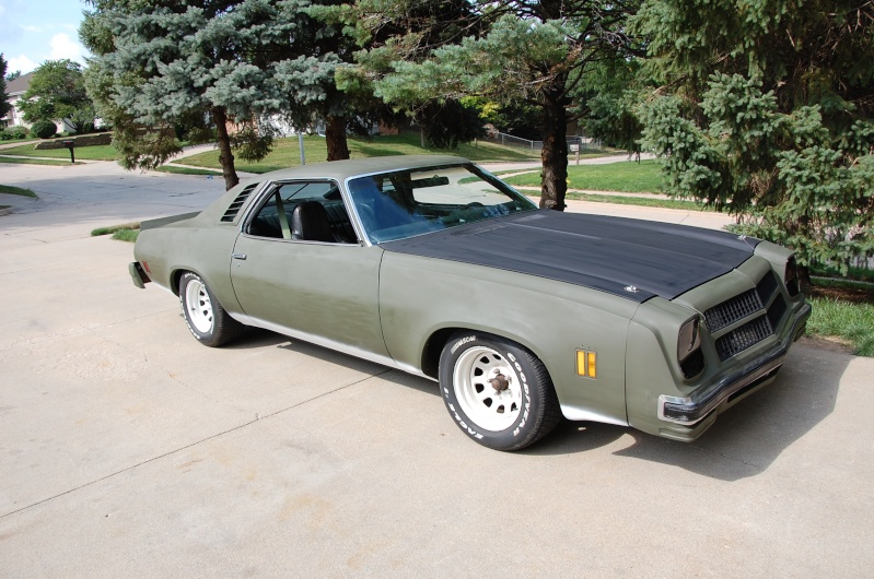

[img]New paint Dsc_4811[/img] This is what is was prior to painting it. For the past 6 weeks I've had my dad's car in my garage doing all sorts of mechanical and cosmetic work to it to get it to where you see it now. sanding sanding and more sanding...It was just a budget paint job done in my garage obviously but I'm very happy with the results! I think he paid about 500 bucks total, which is way more than I even paid when we did mine with the same paint.

We just used a single stage paint. No base/clear coat. Shot it with one light coat of primer sealer. Let sit for 15 mins. Then shot it with 2 medium wet coats of paint. Done. No buffing or color sanding. I'm pretty happy with it and I know he's estatic to have it back to it's original paint scheme, and just painted again period. lol
