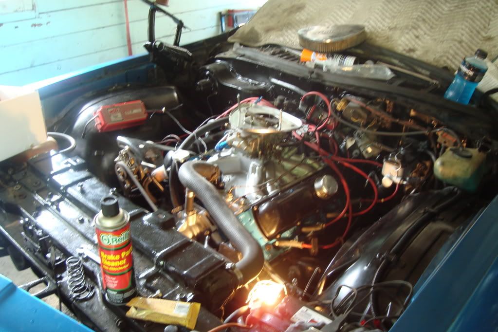

im thinking about going a lil darker on the color and maybe some black graphics havent decided yet lol but heres some more recent pics the top came off and i found a mess so i had to replace the top so now the car is a hard top no more vynal and just had a fresh motor put in [img]my 1974 cutlass 442 project Oldsfront2[/img][img]my 1974 cutlass 442 project Oldsrear2[/img][img]my 1974 cutlass 442 project Engine18comp[/img]the motor pic is before i had it rebuilt and repainted

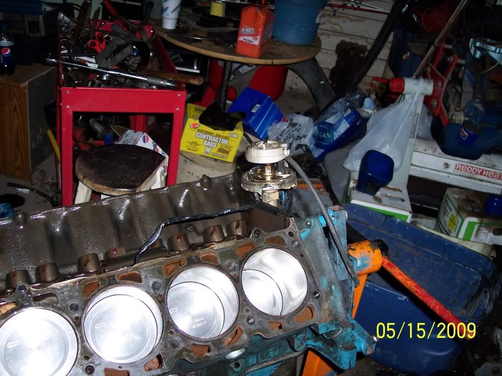

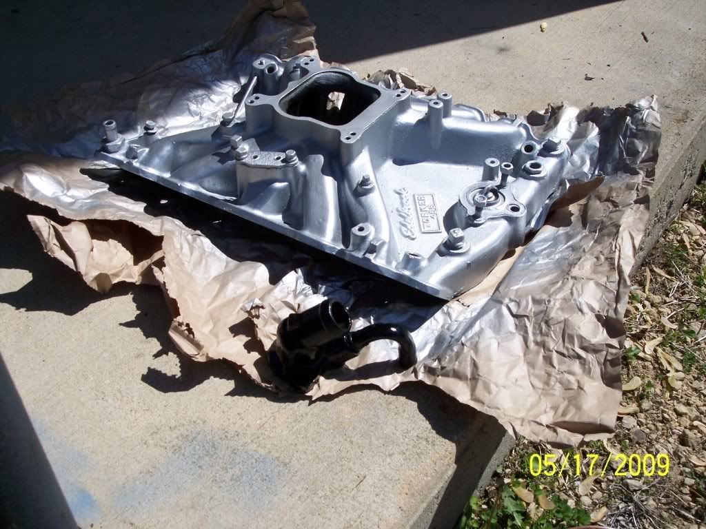

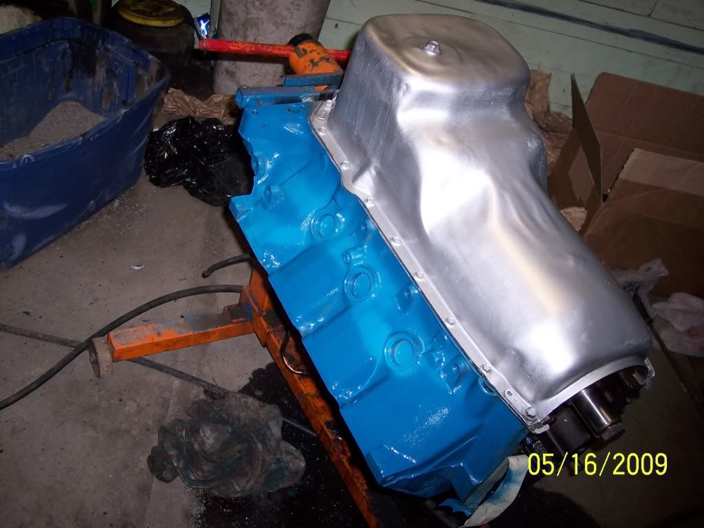

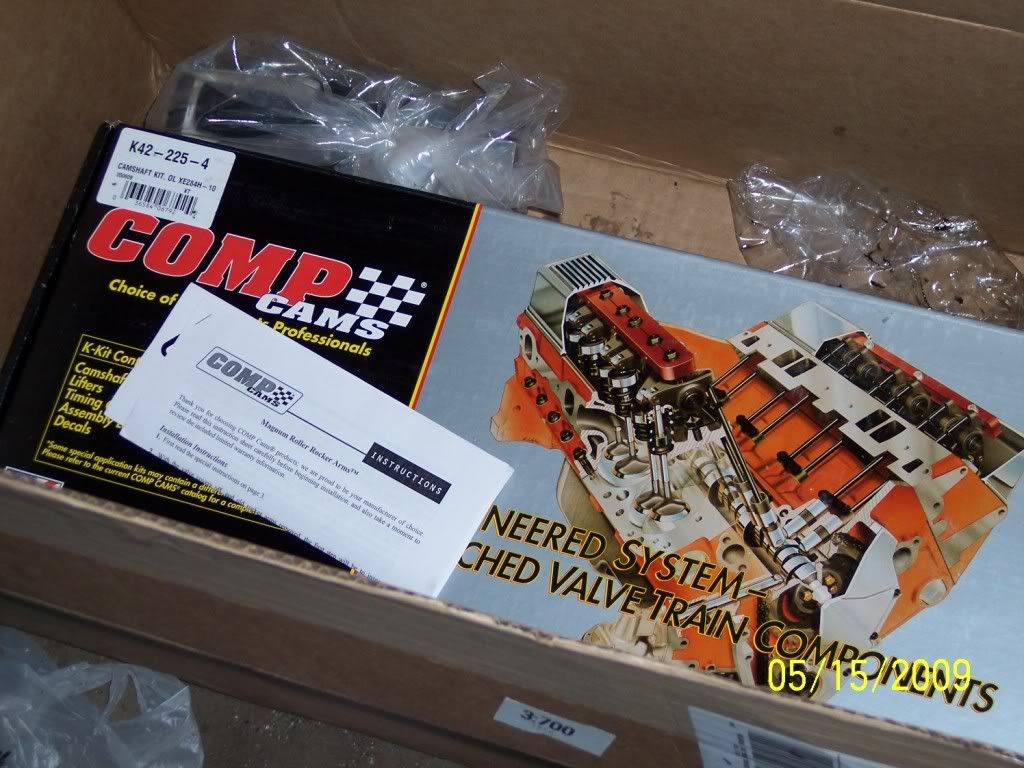

Post by 74442guy on Mon Sep 07, 2009 2:59 pm
these are some of the new parts i used to make this one sick a$$motor its a 455 big block olds motor punched 40 over making it a 462 i went with 11.1 forged racing pistons,molly plasma rings and eagle rods,steel crank and clevite bearings.I went with the comp cam extreme energy 284 camshaft and roller rockers 1.7 ratio rockers.rebuilt c racing heads with the biggest valves i could put in and cleaned and redid the oil galleys for better oil return.backed by a built turbo 400 trans and 410 rear gear makes one sick combo[img]my 1974 cutlass 442 project Picture054[/img][img]my 1974 cutlass 442 project Picture033[/img][img]my 1974 cutlass 442 project Picture036[/img][img]my 1974 cutlass 442 project Picture060[/img][img]my 1974 cutlass 442 project Picture078[/img]
