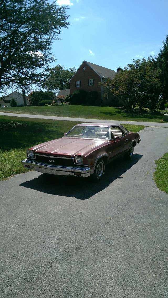

Update pics show my "day 2" version. Came across these on local craigslist, p215 65 r 15 up front with p275 60 r15 out back, stock suspension. My factory correct rims are being saved for restoration and I have all the centercaps and trim rings thanks to the help of Anthony and Mark. But for now I like the day 2 look, and the Cragara have radials on them for a modern road feel.

Looks real good. I like that size tire on the back. Fills the wheel well. Good work.
I'm doing the same thing with my factory wheels. I'm going to have them dustless blasted along with my entire underneath of the car, fenders, doors, trunk lid, hood and roof. And my buddy brought over his set of factory olds wheels to be blasted as well. So I'll be shooting epoxy primer on all the bare metal and the wheels will get some argent silver. Then back to sleep they go.
