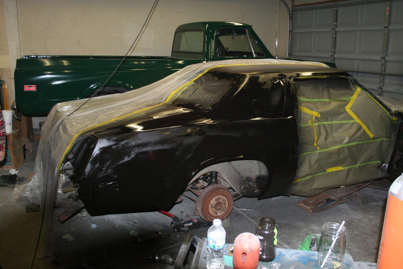

Hello Guys and Gals,

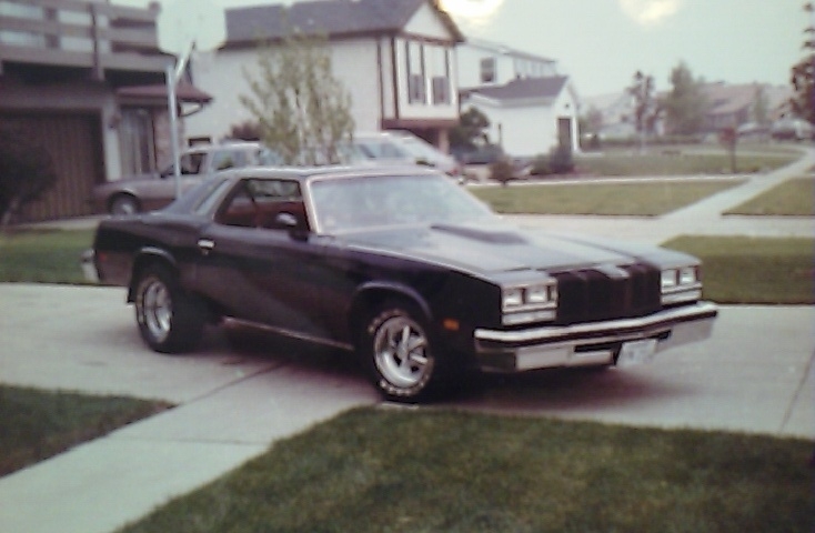

Well I started the restoration on the 1976 Cutlass Supreme that I will outfit to replicate the car I drove in high school.
high school car circa 1983

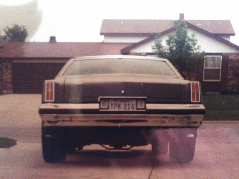

high school car back end

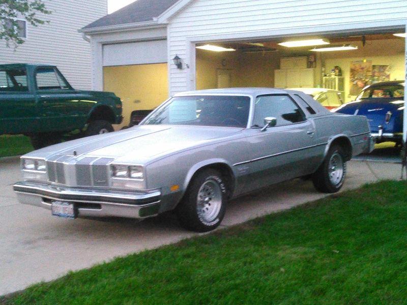

Here is the one I just picked up, 56,000 original miles, mint interior (same color as high school car). runs and drives great:

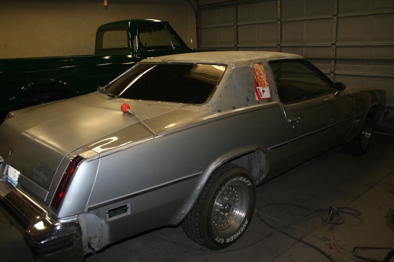

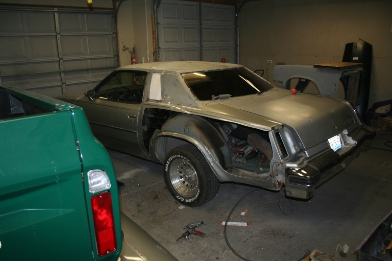

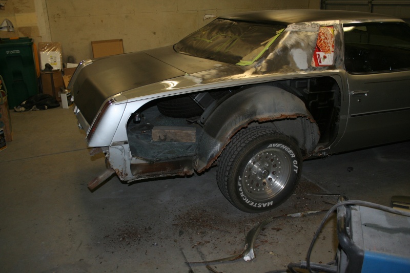

Started by removing the vinyl top:
cutting off the old quarter panels:

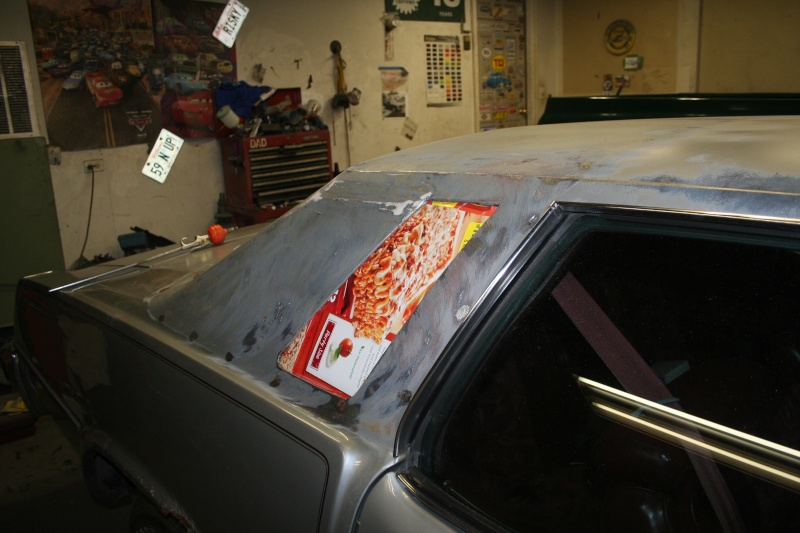

Re: '76 Cutlass High School tribute restoration. Update: frame swap.
Were they in bad shape? They didn't look too bad, especially the driver's side.
Mmmmm...Stouffer's lasagna.

bodyworked new fenders:
new quarters going on:
DaveFury- G3GM Member
Mmmmm...Stouffer's lasagna.[/quote]
Oh yeah, they were bad:

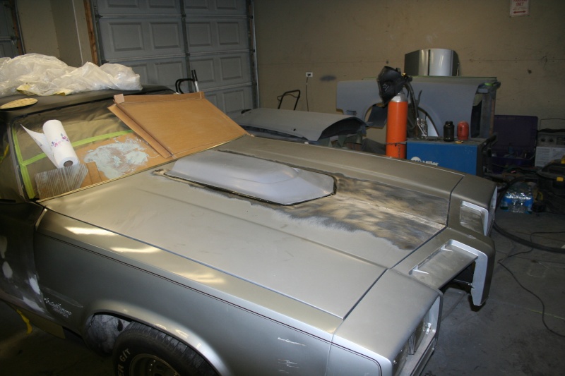

welding up the trim holes:
scoop mounted w/ 3M panel adhesive:
some fiberglass:
a little filler to smooth things out:
scoop in 2k primer
trunklid sanded and bodyworked:
epoxy primer sprayed
2K urethane primer applied:
some fiberglass:
scoop in 2k primer

Nice work. Looks good. In the 83 back end pic. What sway bar was under there? Looks like a 90s b body bar.
- Street Cred : 80
Joe73 wrote:Nice work. Looks good. In the 83 back end pic. What sway bar was under there? Looks like a 90s b body bar.
Damn your good! I swiped it off my Moms '80 Holiday 88. She said I could have it because she never cornered faster than 5 MPH. (LOL) I picked one up off E-bay for this one from an Impala SS.

Both lower door pinch welds were rotted (big surprise). The one leaning up against the wall is one of the originals. I managed to locate two rust free doors that just had some minor dents.
driver door bodywork:
driver door in 2K primer:
pass door in epoxy primer:
pass door in 2K primer:

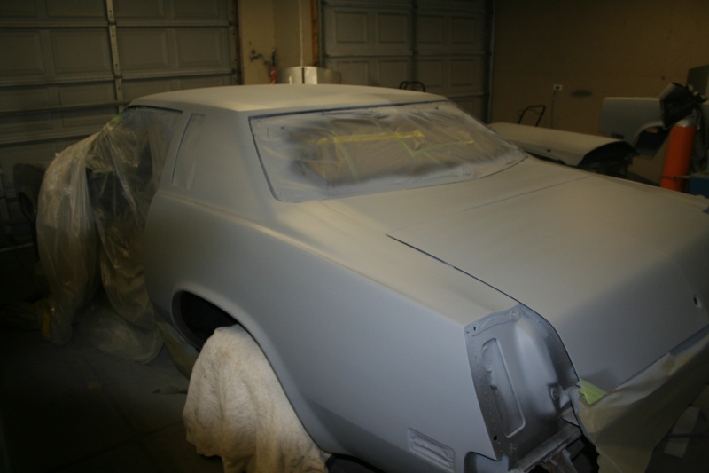

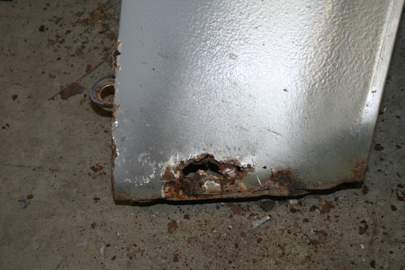

The bottoms of the original doors were in pretty sad shape:
Replacing the fenders:
They were pretty bad too:

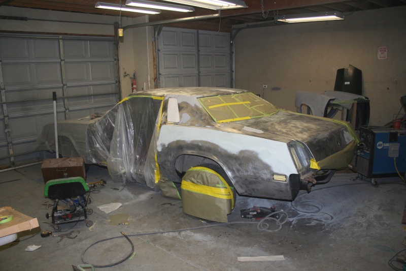

New fenders and doors aligned and a second coat of 2K primer after an entire weekend of block sanding:

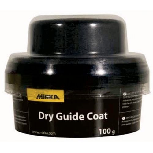

Are you using guide coat during blocking? Looks great.
- Street Cred : 80
Joe73 wrote:Are you using guide coat during blocking? Looks great.
Yup, the dry black powder type. I have to use it, my old eyes can't spot the imperfections like they used to, (LOL)
