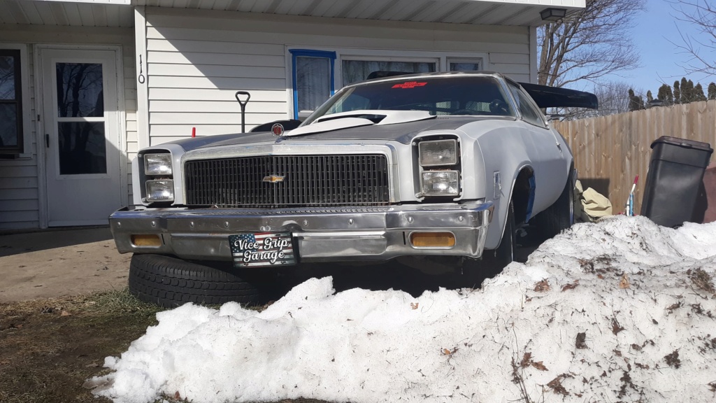

Well I have finally decided on the scoop to add on I have a glass hood I am bonding it to its a pin on hood BUT gonna use Camaro 3rd gen hood supports if it Holds a steel Camaro hood it will have no issues with a fiberglass Hood.
Also the glass hood has no rear Cowl vents on it, So the scoop will get all the Air from the G SPOT of the windshield, Also Have to get the Other Cragar Style wheels mounted I needed rotors anyways why I wasn't worried about snow being packed around a bare rotor

Corvette Stinger style hood my friend in PA put one on an Impala and I knew this had to be the scoop for the SE Not to tall not to short and will be going on my fiberglass hood
I DESPERATELY NEED A NON ORNAMENT HEADER PANEL NOW PLEASE HELP ... I am loosing the Ornament as it doesn't fit well with the scoop

Maybe either weld up the ornament hole or fiberglass it closed when you do the hood. Very easy.

FELT GOOD TO WORK ON IT FOR SURE
Well More progress is Progress, Only took 4 hours With My portable Oxygen to do One side Between hunting tools down from Shed and tool box ( I need organization in my tools LOL )
Any who seals, bearings, rotor on one side is done Tomorrow is outer side and also installed Gorilla Locking Lugs on the wheels
Man does it feel good to be able to work on this Vehicle and Thankful I still Can !!!

Well Felt good Enough to Finish Passenger Side Seals Bearings Rotor today Slow and steady wins the race is what they say... Any thank you for the Continued Support from y'all means Alot.
I did a switchup on the Lug Nuts though I found some Black Gorilla Lugnuts Locally for 25 bucks to me from Chicago area so Gives a little different but Cool look I think
My 11 year Old Elizabeth even helped me Today she thought that was the cats Meow even Helped me Put on Sisters Turbines (insert sad face here) Yes she won the battle of the wheels
