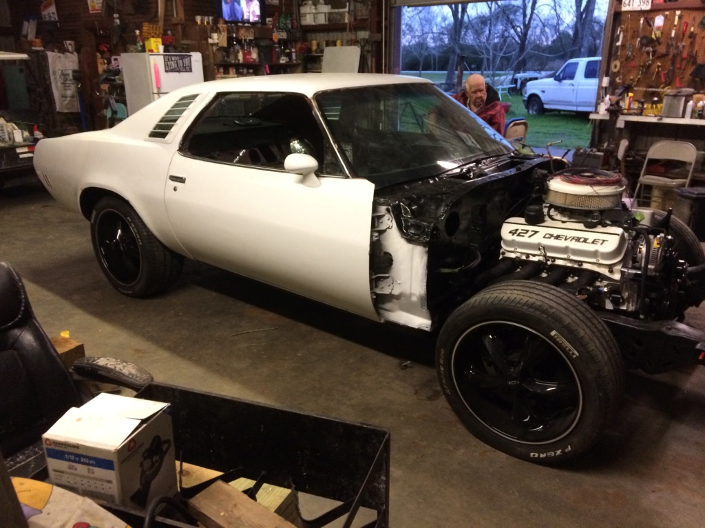

Post by REVINKEVIN / Mr. 600+HP Tue Jan 29, 2019 11:13 pm
What a day.  Massive thanks to g3chevy and to an unexpected group of retired farmers.  When I got to the barn my father in law had some retired friends over for stew.  When Bill got there we started working.  Much to our surprise, all of the older gentlemen were all into doing a body swap on a Laguna.  About 8 of us worked for about 6 hours and did the deal.  It was awesome.  I can't think Bill and the gang enough.  It has been a lot of work and sacrifice to get to this point.  Now the body is on it's new home/frame.  I hope to get a lot of items bolted to the car in the next few weeks.  I hope to try and start it in the next couple of weeks.  Here are some pics...
Where are you at picture - Page 10 Swap_010
Where are you at picture - Page 10 Swap_210
Where are you at picture - Page 10 Swap_310Where are you at picture - Page 10 Swap_510
Where are you at picture - Page 10 Swap_610
Where are you at picture - Page 10 Swap_710

Post by g3chevy / Mr Pontiac Tue Jan 29, 2019 11:58 pm
What a fun day with a great bunch of guys! This is truly what the car hobby is all about. Thanks for including me on this project Kevin! Even more pumped than you about this beast getting finished!
