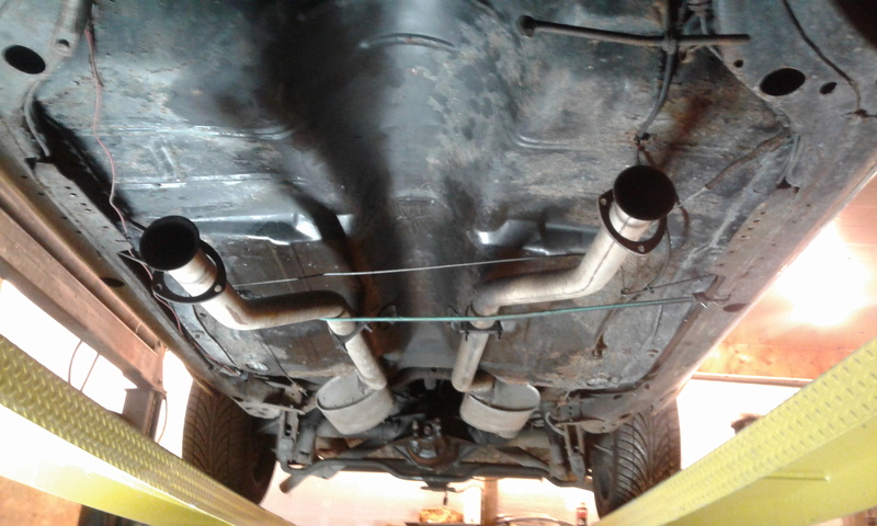

I am waiting on parts for a customers car so I got a chance to put it up on the lift and check out the underside really good. It looks pretty good. It will need some patches in the floor behind the seat and under the bolt on panel in the bed. Someone at some point did a bondo over pin holes under the bed panel. My parts car was an oil thrower so the floors in it have no holes so I can get sections from it to repair mine. Other than that nothing else has rot. I'm going to remove the exhaust and tank so I can degrees and pressure wash it. I'll work on converting the tank to an in-tank pump for the fuel injection. I do not have any work that I need the lift for so that will be its home for a while.

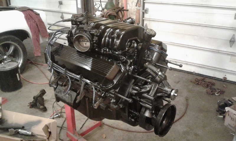

I was able to get some more work done on the Elky this week. Pulled the windshield and discovered some surface rust where it had leaked and someone filled it up with sealer. Its not bad. I'll blast it this weekend. I did get my engine assembled this week.

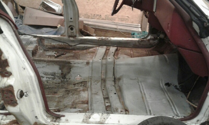

It was a busy weekend. I was able to get the body separated from the frame and get the floor cut out. The floor was in good shape from the first floor brace forward so I am just going to replace from there back. There was a little rust in the area under the front of the bed. I have to replace some of the lip the bed pan bolts to and patch a couple holes on the passenger side wall.

I was able to get back on the Elky after a short break for the Holiday and hunting. The floor is back in. It was a bit tricky getting it in. I ended up going through the smugglers hole in the bed and sliding along the tops of the rockers. I had to use a little foot stomping power but it finally went in. Rear corners got bent but went right back down with the hammer.
I'll get the section of rear wall in and button the floor up tonight then that is it for the underside. The driver quarter has a couple small holes after sandblasting so I will tackle it next. The passenger side was not as good. In front of the wheel about 3" up is gone, around the wheel arch is a hole and behind the wheel is pretty bad. I was able to find an NOS GM quarter so I will be replacing that side.

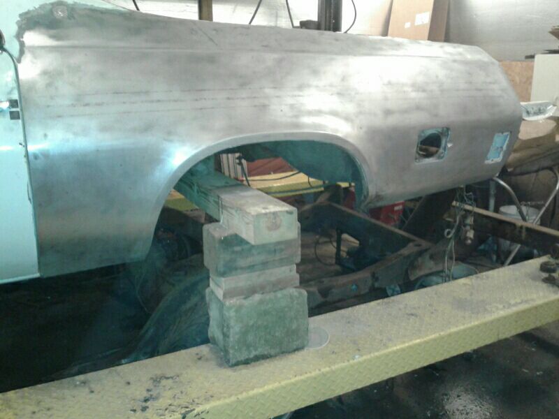

The old quarter is off. Only 2 spots of the inner structure needed fixed. Mostly some surface rust that I cleaned and sprayed with zinc primer. Should have the new quarter on this week. Then all the metal work is done.

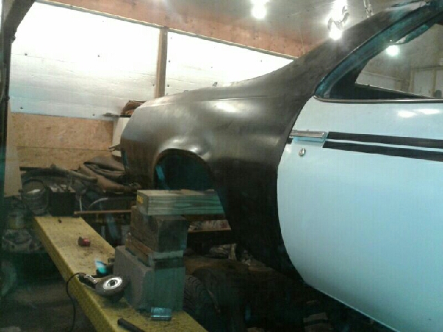

Stripped the driver quarter this weekend. No real issues. A couple of small areas of filler from some dents. There was surface rust where the original stripes were. Confirmation it is a real SS. I had no documentation or could I find anything. It only had 1 repaint in its life. It used to be brown. I am still not sure what color I am going to paint it. White again or black and red like the one I had in high school.
