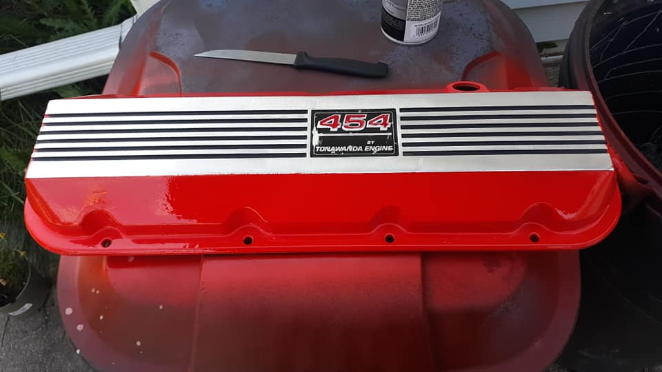

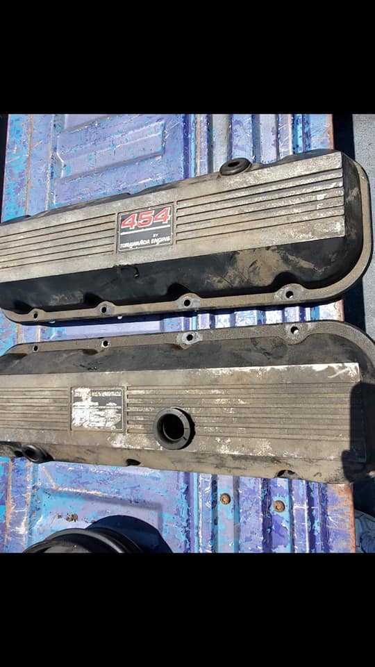

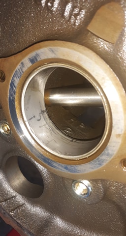

Heads are back and ready to rock Have to get cam kit and gaskets and can open it up and see what I have

Ok so sold the stock 454 heads from 1987 to a guy unexpectedly didn't think they would sell so fast LOL ..... so had to come apart sooner than expected actually doesn't look half bad will drain remainder of oil in it and flip her over and check bearings any idea on piston cc foe this year dont want to take to shop JUST for that ? Doing the build at home as much as I can .... Put heads on so they wont get warpped after getting done just snugged them up

I would guess them at +5 cc as a good guess.  Depending on the compression calculator you use, a dish is a positive CC addition.  So that's what I would use. Is that the oil pan out of the motorhome? That looks like a big sump on that pan, but could be the picture.

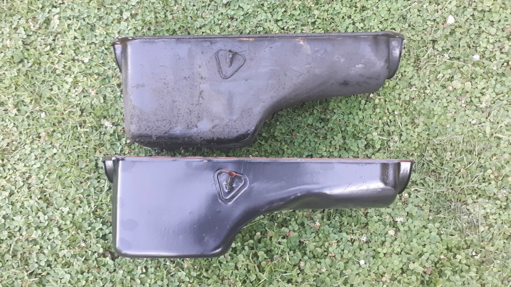

No Ray it might just be the picture this oil pan is for a car the RV one is still on motor and is bigger than this one .... Just waiting on Bump stick and gasket set to arrive .... but need some parts to sell first

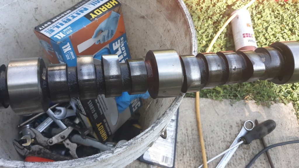

The other Cam Had 527/553 Lift and was at the extreme limit for stock pistons Had picture proof of the damage BUT Like mentioned he changed his Valves to a larger size BUT all in all this is still WAYYYYYYY bettter than the stock size was

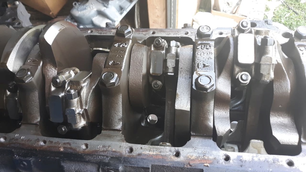

Post by Limey SE Fri Aug 02, 2019 8:49 pm
Update: Motor is apart Cam was well Tired to say the least BUT for a 67 thousand Mile Motor home motor, Cam was not really all that bad (NO Not reusing) anyhow its dissembled Have to pull cam bearings for sure Will check crank and main when I pull a cap or two off in next few days and Some one asked about the Oil pan difference I dont remember who BUT took a side by side to show difference from RV to car pan
Also with the balancer I am looking to replace it because of the grommet cracking and coming out of the groove so have been advised to R/R it But replacement one is different it only has two drilled Holes in it instead of 3 in my mine and weighs 15.25 (new one) I haven't weighed mine yet the second one BOTH SAY direct replacement and the Second one weighs 15.40 pounds.
Anyways Enjoy pictures Cant wait to get this Back together WOOT WOOT

Post by bracketchev1221 Mon Aug 05, 2019 8:37 pm
The cam that came out looks perfect. I would not be hard pressed to leave the cam bearings alone and put it together. As far as the balancer, the holes mean nothing. That is to neutral balance the hub. The counterweight is the important part. Generally they are pretty close but you can have the two of them spin balanced to make sure they are equal. I asked the question about the oil pans because the picture looked funny and many people have tried to install truck pans not knowing there was a difference.

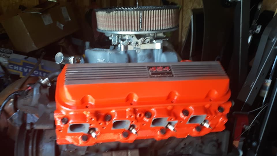

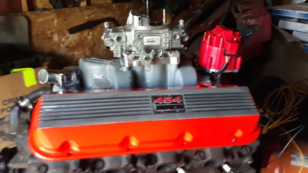

fiance Got me belated Birthday gift, I think the Black label will tie  the Black on Valve covers nicely I wanted a black one BUT not in the  budget right now and for a Birthday gift you don't complain,  I kinda  like it more than I thought I would  (I already had the decals in advance of air cleaner)

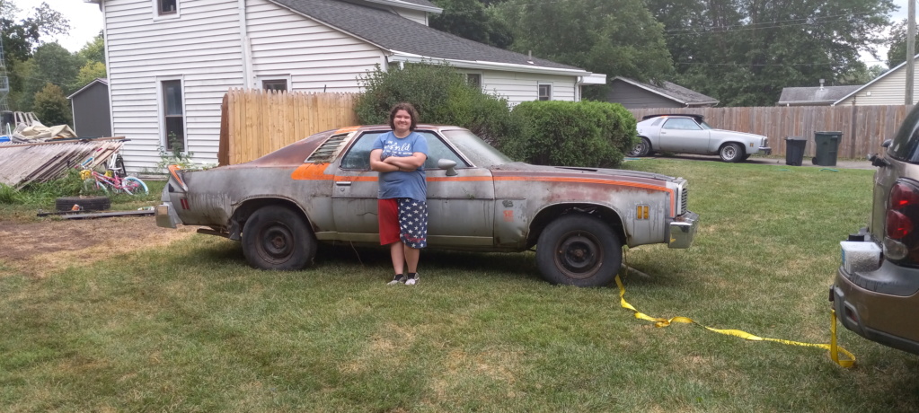

Well a little update on Daughters SE yes ya heard right Daughter gets it if grades stay good her SENIOR year so the 454 def goes to my Car and she gets a 67k mile 1983 305 from a Caprice wagon my friend sold us runs dam good so good just need to decide whether I'm using the th350 or the motor home trans th400 in my SE .... its drop in ready with a New dist cap wires and plugs I stupidly broke two they were just put in LOL I Seen the 305 drive on off trailer and around block for minute or two almost thought for how well it ran that it might have been a 350 but numbers don't lie.......
But pulled her out of hiding and she is gonna start on roof first before there isn't a roof to start on LOL 🤔  Anyways she gets a job and THEN she will start paying for her own supplies LOL 😉
Anyways here we go YOU CAN SEE MY SE Photobombing in one of the pics

Post by Limey SE Fri Aug 13, 2021 12:39 am
Been after me for months after my knee fracture to pull it out of the hiding spot then Got Covid LOL last few weeks she is really hammered me to pull it out from hiding so she can start working on it
