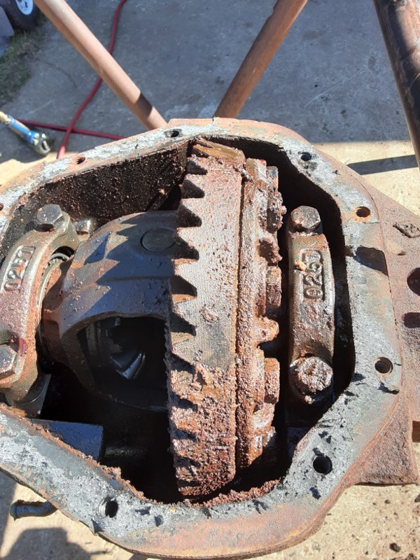

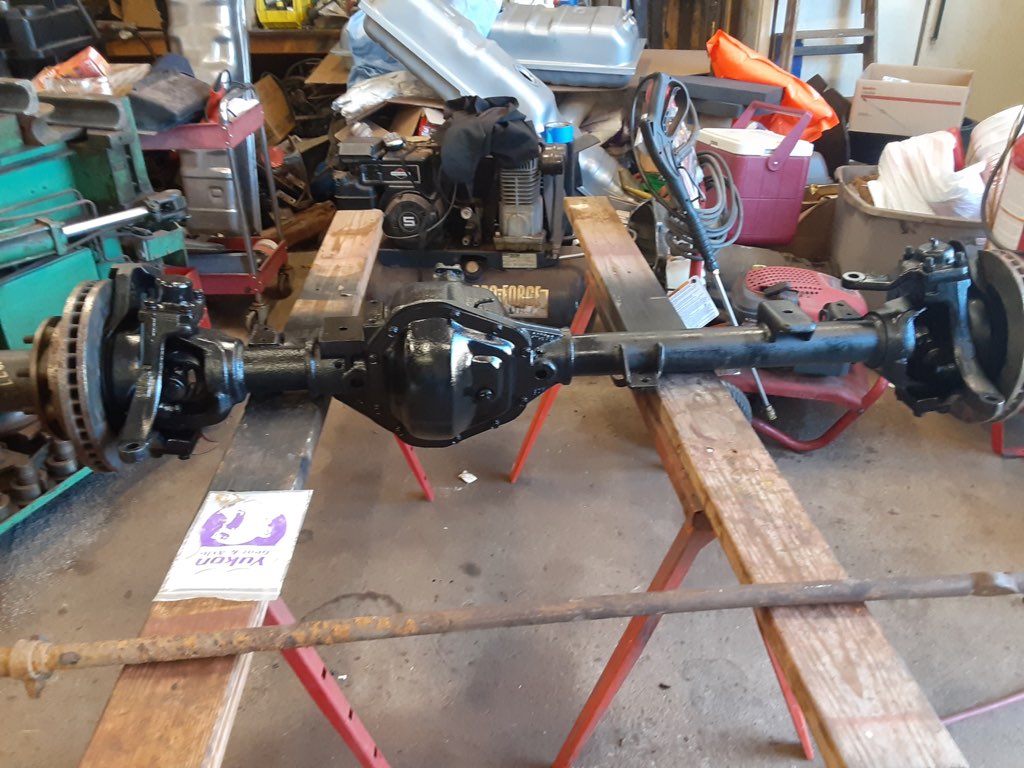

Been a long summer with little getting done. I brought my Dana 60 to guy who rebuilds them (along with trans and t-cases), when he opened it up it was full of water - we were able so salvage the housing/tubes, knuckles and spindles! Since I needed a new carrier I went with a Trac-Lok and replaced the 3.73 gears to match the rear 14-bolt. All new axle shafts, bearings, races, hubs,.....
